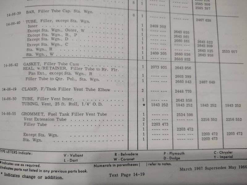

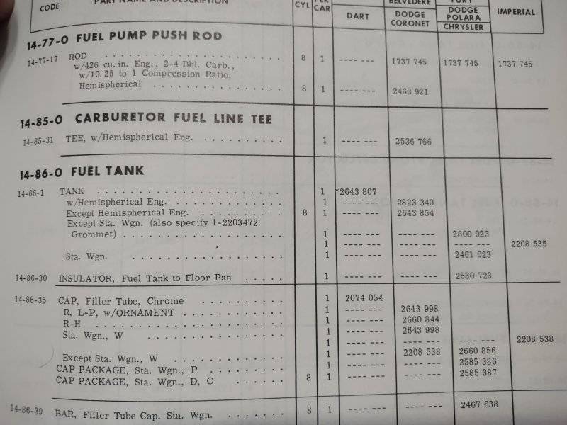

I have a 66 Satellite tank out back.
I can take pictures and a few measurements if you think it would help?
I can look in my parts book as well...

It's not out of a wagon.
Correction I was looking at the wrong column.
Apparently they are the same.
The Mopar parts books can be confusing at times. I have had to study mine pretty hard at times to figure stuff out.
The way I am interpreting this is that the tanks are the same in the B Body cars. The filler tubes are different between Dodge and Plymouth. And wagons different than sedans. Plymouths had the caps exposed on the 1/4 panels. Dodge hid the gas cap behind a trap door. In the parts books, the B bodies are in the second column. The Plymouth Belvedere cars are designated as the "R" line, and the Dodge Coronet cars are designated as the "W" car line. (1st letter in the VINs)
Interesting that the B Body Hemi cars show a different part number for the fuel tanks. Can anyone explain what is the difference?
I have a Mitchell's repair and replacement parts listing for my 1967 Coronet. It shows the same gas tank for all 1967 Coronets.
Could it be the sending unit came with the tank and it's a 3/8" line?
