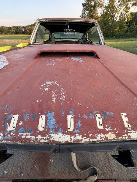

I’ve been hitting marketplace hard looking for a four speed setup. Then reading up on what it takes to piece together a system and costs, etc. Then, this ‘67 popped up 120 miles from me.
1967 Charger. 383 four barrel (only the block, crank, intake, heads, and carb) Four speed transmission! Sure grip 8 3/4 with 3:23. Missing windshield. But seems like EVERYTHING is there as far as glass, wiring, trim, interior, etc.
I got into the Mopar game just a couple years ago and I own 4 (66-67) Chargers. I think I can get 3 runners out of the four cars and motors that I’ve purchased. Ironically, I need more healthy transmissions.

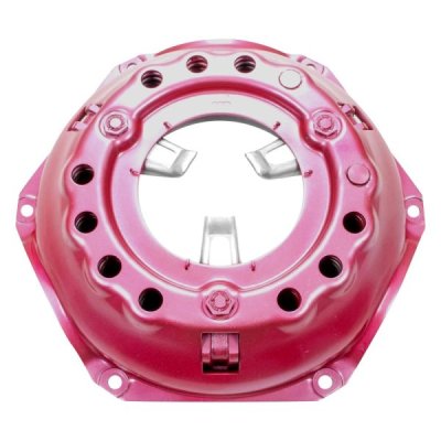

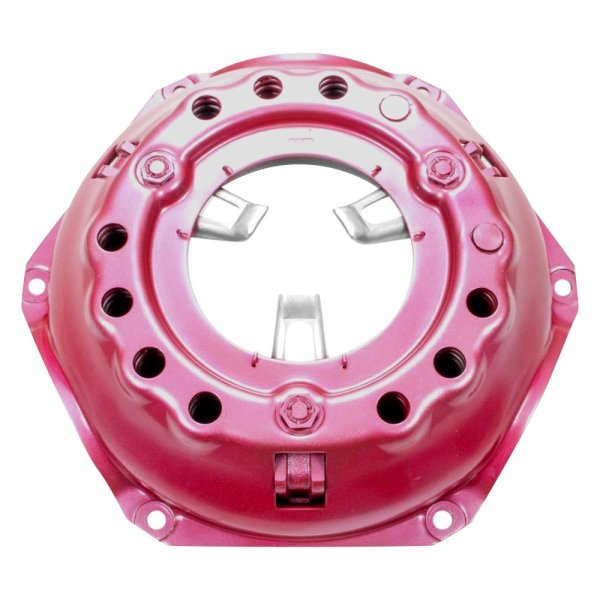

There weren't any hydraulic clutches on these back when new.
They typically had Borg & Beck ("3 finger") clutches from the factory:

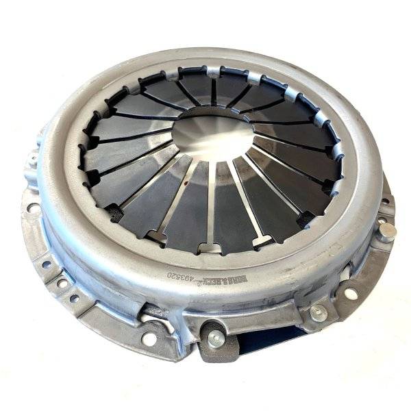

The market these days is pretty much overwhelmed with the "diaphragm" style pressure
plates:
B&B are still out there, you just have less options in that style than you do with diaphragm -
and of course, they feel noticeably different when driving the car and as previously mentioned,
diaphragms necessitate removal of the clutch pedal over-center spring under the dash.
You can go hydro if you wish - but you're going to have to buy all the components for it and
cobble it up yourself to do so.
