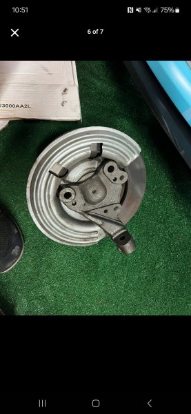

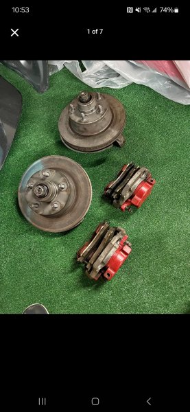

He doesn't have much info to offer. Here's some pics. I looked up the part number and found the calipers but not what they're from. Nothing to go off of for the rotors. Would be nice to know what replacement parts to buy.
Contact Dr Diff.
That's what I did when I converted my 67 over, he'll setup you up with hoses and get you a lighter MC, Fyi I did get a prop valve from him, haven't installed it but so far no issues without it, been 3-4 years now.
Street/strip car
Looks like pin style calipers. 70- E/B and many other mid to large cars. D39 style pads. A body calipers, slider style from 73-, use D84 series pads. So say a Raybestos PGD39M would be a number to use or crossover from.
