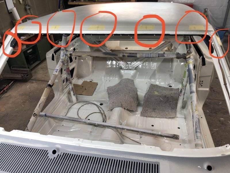

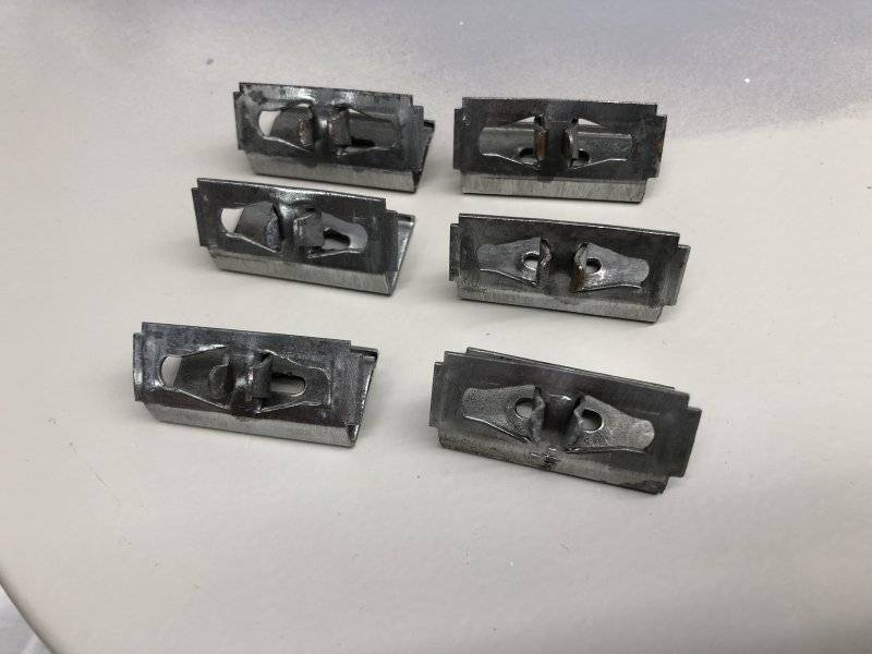

Dear all,
I just installed the headliner on my 1967 Coronet and need a little help with the clips for the inner chrome molding. There are seven holes but just six clips. I just found sets of 6 to buy, so it looks like I didn´t loose one. Does anyone know which holes to use? There are 5 holes in the roof header and every A-Pillar got one. I searched many topics about this but couldn’t find a clear pic of them all installed together.
Thank you very much in advance!!
Regards
Jan
They have 5 across the top and one at top of each A pillar for 7 total.
I can measure mine but the holes should be there on Your car.
Just because the aftermarket sells in 6 doesn't mean anything.
Hey,
thank you very much!!! Then I might have lost one or it slipped in one of the other boxes
Thanks again!
