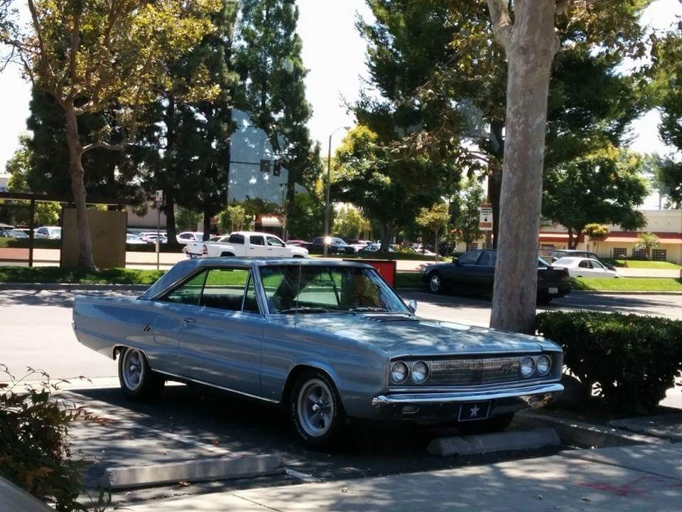

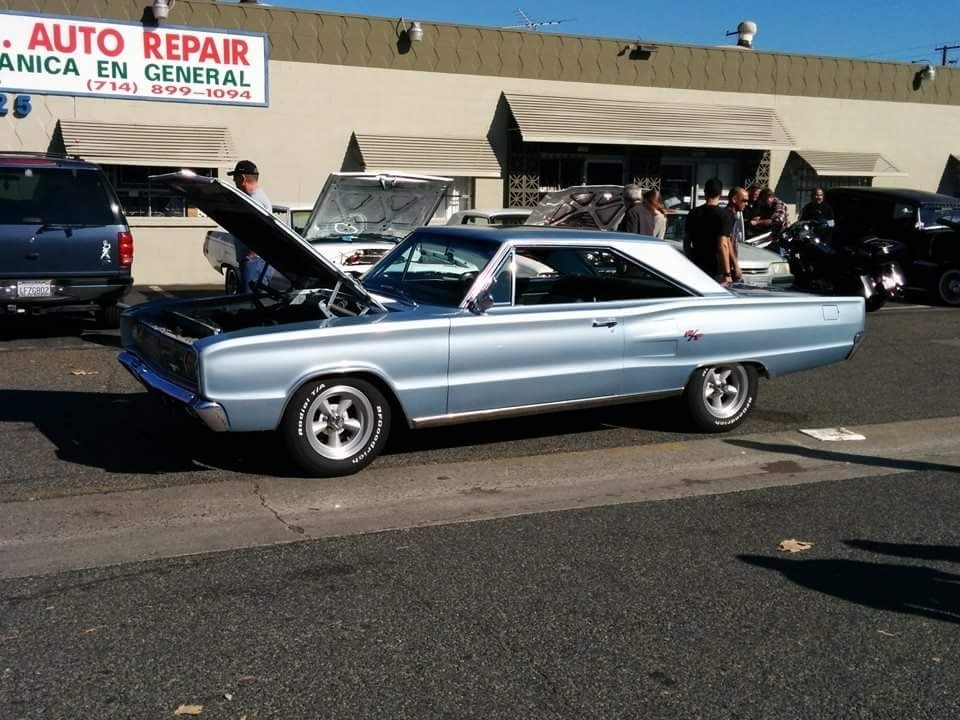

I run a set of 225 70 15 Goodyears on 15 x 7 cop wheels. No clearance issues at all and I think they really look great on my 67 Coronet.
