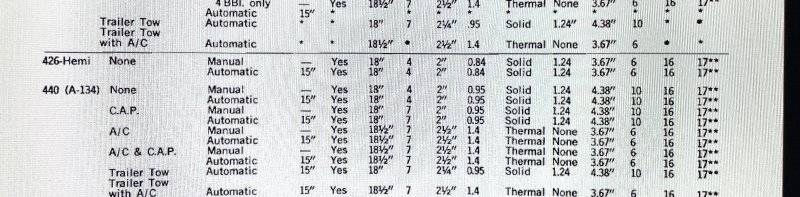

1967 Hemi Coronet R/T - what is the correct fan? HELP
So it is automatic trans?
What is the SPD?
4 Speed Jan 67
If someone has the same Hemi drivetrain combo and a buildsheet saying what fan, I think that’s real good evidence.
With same rear end ratio even better.
