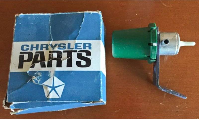

The system uses a vacuum control valve installed between manifold vacuum, carburetor ported vacuum and the distributor vacuum advance.
The article states:
“The system comprised this control valve, a carburetor with leaner and more precise calibration, and a distributor with a modified centrifugal advance curve to provide normal levels of spark advance for acceleration and cruising despite the retarded basic timing.”
“Starting in 1966, CAP became standard equipment on all Chrysler Corporation vehicles sold in California, and Chrysler even offered “UCCAP” (Used Car Clean Air Packages) at dealer parts counters, for retrofit to any 1955 or newer Chrysler vehicle.”

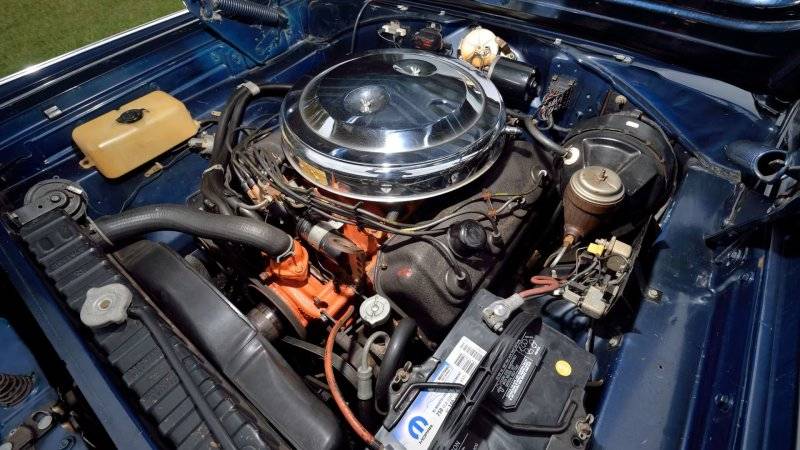

I have some literature around here someplace. But best I remember,,, the only thing different on St Hemis was CA sold car had a hose from air cleaner to valve cover breather.
NON CA sold cars just had a cap on the air cleaner nipple and the valve cover breather didnt have a nipple.
NON CA shown for reference.
PS, there is some argument/debate as if this breather is/was chrome, OR black

My CA original 66 Hemi has that black cap on the air cleaner and no nipple on valve cover.

Yes in CAP cars the crankcase ventilation became a closed system and the breather got a nipple to go to air cleaner so any emissions are burned through engine, either at vacuum port from PCV or through air cleaner if venting from cap. Not sure about 66 but 67 hemi/440HP was a chrome valve.
