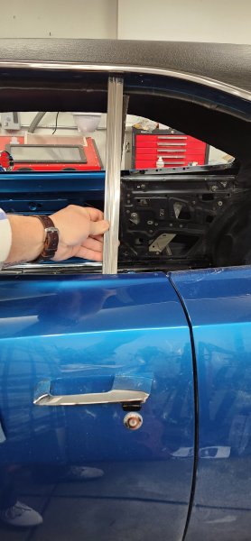

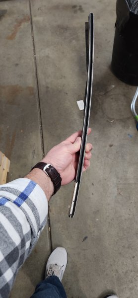

Does anybody know if they make an aftermarket seal that goes in the U shaped channel side of the door glass trim? This is the trim that mounts on the door glass and closes up against the quarter window. I know they make a felt seal that closes against the quarter window, but I can't find a new seal that fits in the U channel side of the trim that actually goes on the door glass. It feels like its rubber not felt like the seal on the other side of it. I'm trying to post a picture, but its not working.
Thanks for the help.

Everything you need to know.... what will throw you off is they list it for 64-66 Dart. VS7-E/FL National Moparts # WS0013A
Broke my 7UP Pop Machine today....
EDIT: I read it wrong.. but same thread applies, just follow it for a couple pages. It'll show you it goes on with glass setting tape, 50thou is prefect.. 60 works.
Excellent. Just what I was looking for. Putting that trim on with a rubber mallet looks a little scary. Lol Any advise besides soft taps and taking my time?
