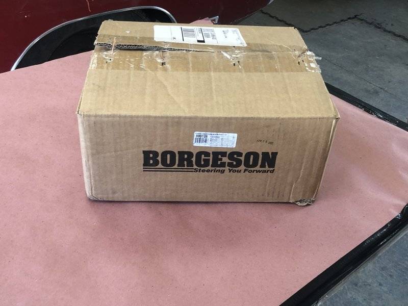

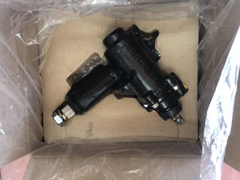

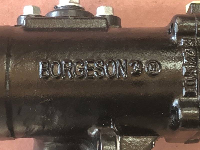

Seems like a great opportunity to just step up to this:
This guy:
BERGMAN AUTO CRAFT - INTRODUCTION
His company is a sponsor here. I've installed 2 of these with excellent results. Other members have as well. This is a NEW steering box that is smaller, 12 lbs lighter and has far better feel than an original steering box. It is not cheap but it is an excellent product.
