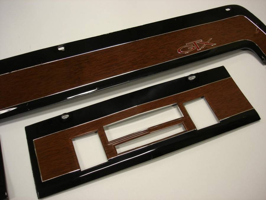

Now, I notice (probably like you just did) that the woodgrain doesn't match between the radio bezel and the panel to the right.
Not at all.
I know the radio bezel is one of those repops that supposedly is for both '68 & '69 model GTX's, but all I knew was the '68's don't have lettering and the '69 does, right?

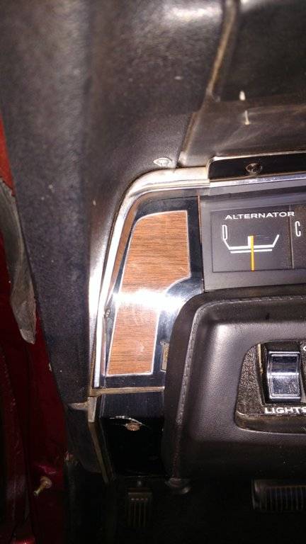

So I take pics of the rest of the woodgrain pieces to try and figure out what's up:
Really, aside from the lousy photography, the only piece of the set that isn't like the others is the long one over the glove box.
The question then begs....
Was there a difference in the woodgrain between 1968 and 1969 GTX's (or by association, Sport Satellites or even Coronet R/T's)??
If so, which one do I have?

Yes....68 is usually lighter and all 69 are a darker....2 fixes find an original lighter radio bezel(good luck) or a darker hockey stick(triple good luck)
The small one is much more common and easier to find....

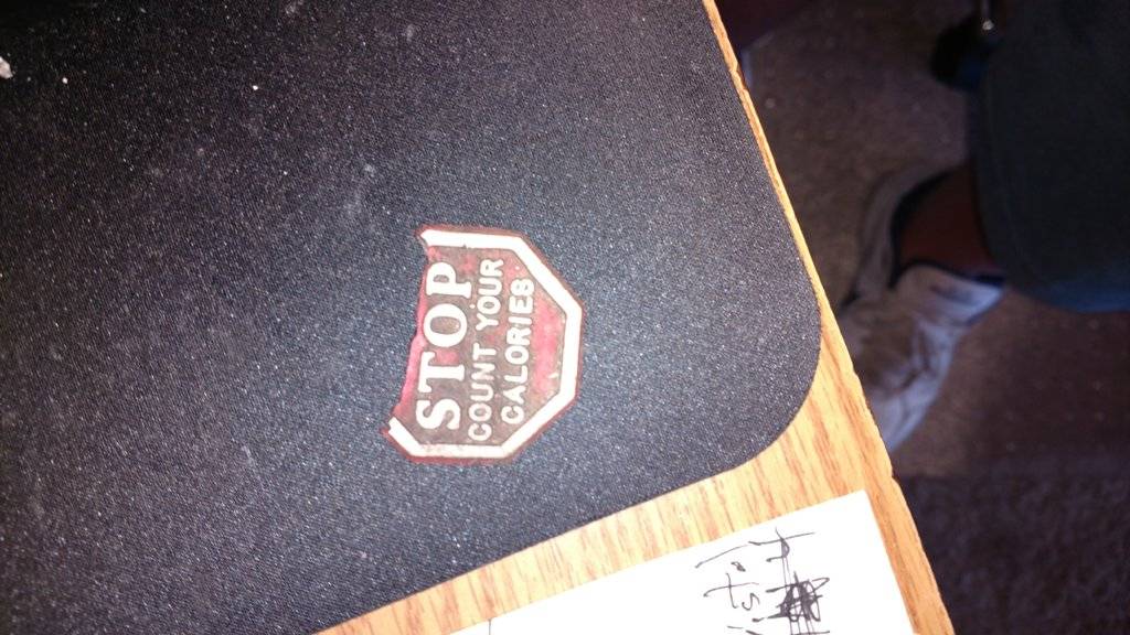

We've all read stories about people finding artifacts in these cars that actually added to their rarity or spoke to their history, sometimes to the added value of the car, right?
Yeah, well....
I found this stuck to the inside of the dash today:
That's most of a magnet from who knows how many decades ago.
Former owner belonged to Weight Watchers mebbe? :D
Yeah, "artifacts".... :lol:
Great. So my door panels, radio bezel and left side small one are ALL wrong, eh?
That's just lovely...
nope....just the radio bezel....Dont worry about the small one....it appears lighter in your pic but if not the cluster breaks that up...you notice but non one else will....
Original lighter radio bezels are a tough find.....but far less costly than a dark hockey stick.....
Ok, so the lighter radio bezel is also the one without the lettering, right?
Yeah, they're pretty much made of unobtanium. Been looking for one for months.

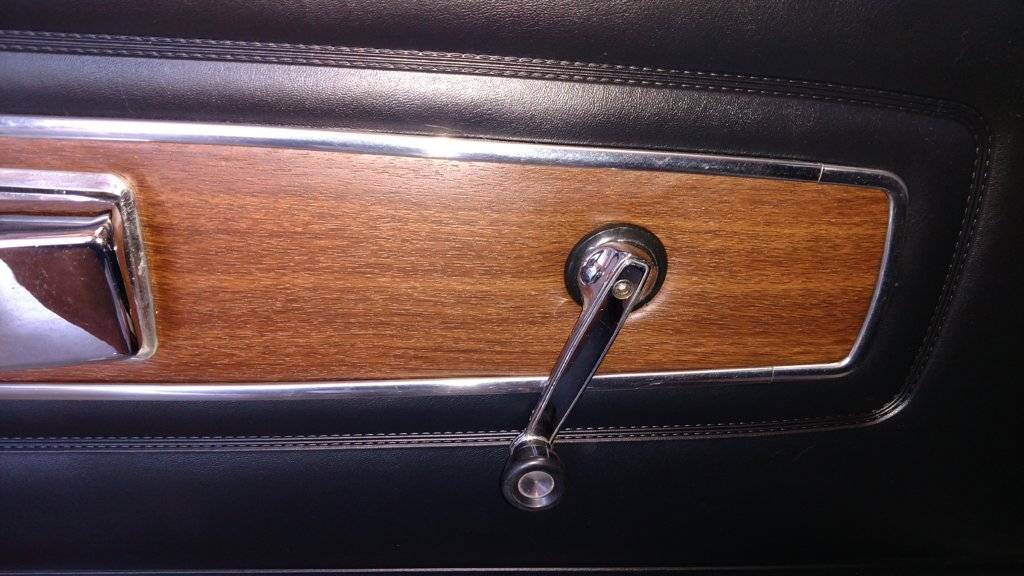

I guess I'm looking for an either/or here, then, especially since the door panels (from Legendary) are equally darker as well.
Lets clear a bit up....Chrysler used multiple vendors for interior components.....not all things match, period...
Door panels were made by a different vendor and the grain will more closely match the console...
On my GTX which is done to OE spec...the red interior has 7 different reds.....it is a sea of hues....
Now just focus on the real mismatch which is only your bezels.....I think they all had lettering...I know 69 all had lettering....

No lettering on 68's for sure.
No woodgrain console in 68 to try to match.
Appreciate it. I thought I'd remembered that from somewhere a while back.
This one is a non-console car anyways.
I guess I'm down to either finding a lighter/non-lettered radio bezel or a darker right side hockey stick.
Until then, at least there's no gaping hole in the dash anymore. :)
