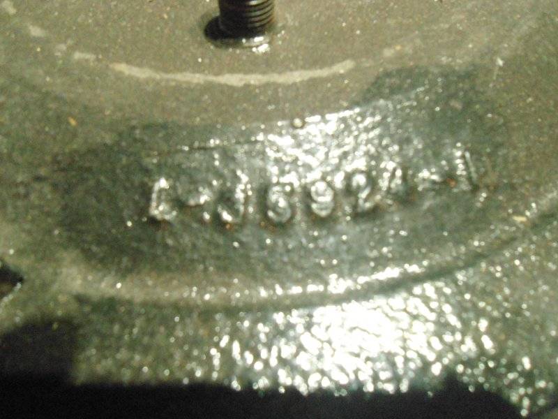

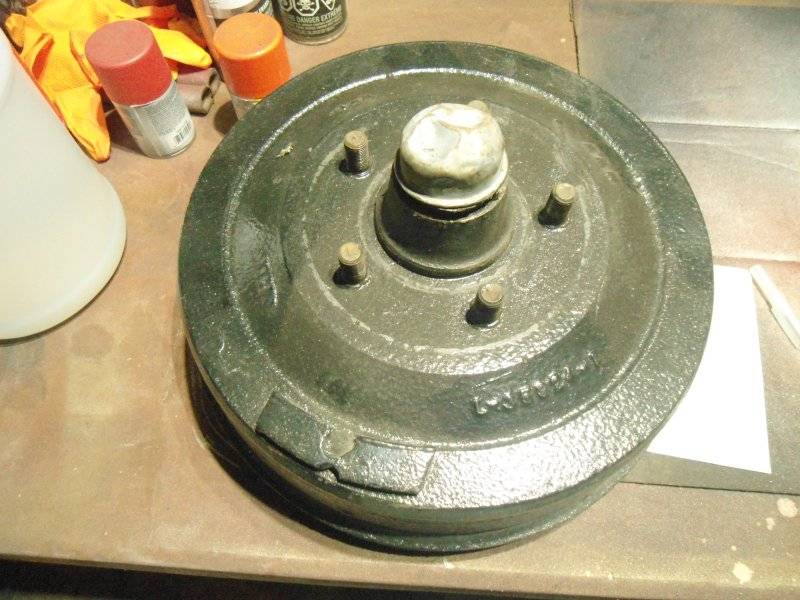

This is the number I took off of a drum along with 2 pics. L-35924-R is what it looks like to me.
Good new drums are getting hard to find. Nos is outrageous, to the point I’d rather do a conversion.

See if these help, a cross reference the numbers. These are 11"X 3" front, the 1938 drums are Raybestos and wagner 60141 these are from the late 70's. not for sale.
