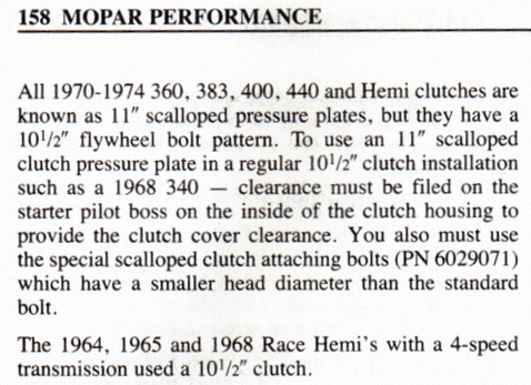

I believe the 143 tooth FW was typically used with a 11" disc setup and cast iron '68-'69 bells. Since the diameter of the 143 FW is larger diameter than a 130 FW, the starter is located further out by necessity. Aftermarket scatter shields can accommodate both FW sizes in most cases.
The 130 tooth FW is typically used with the 10-1/2" AND 11" SCALLOPED disc setups with the '70 and up aluminum bells.
FWIW, one can count the teeth between two adjacent clutch cover bolt holes on the flywheel to determine which FW is installed............
