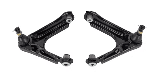

I removed the control arms
I got the Moog new bushing
I assume I need to press out the old outer housing or flange because this doesn't fit
The round outer existing flange look like it one piece with the arm. I know its not
How is this accomplished? Press? Heat?
Thanks
A press would be ideal. I think you can also rap the small side with a hammer to get it moving in the socket.
you could put a couple cuts in that collar and collapse it inward with a chisel and hammer
HF sells an inexpensive press, but it takes up space in the garage. Taking your UCA out to a shop to have them press out the bushings may cost you a $20, if you talk real smoothe-like.
Agreed hit it sideways with a sharp chisel air hammer to collapse it and out in 10 seconds
The last ones I did on the bench with a HF press
