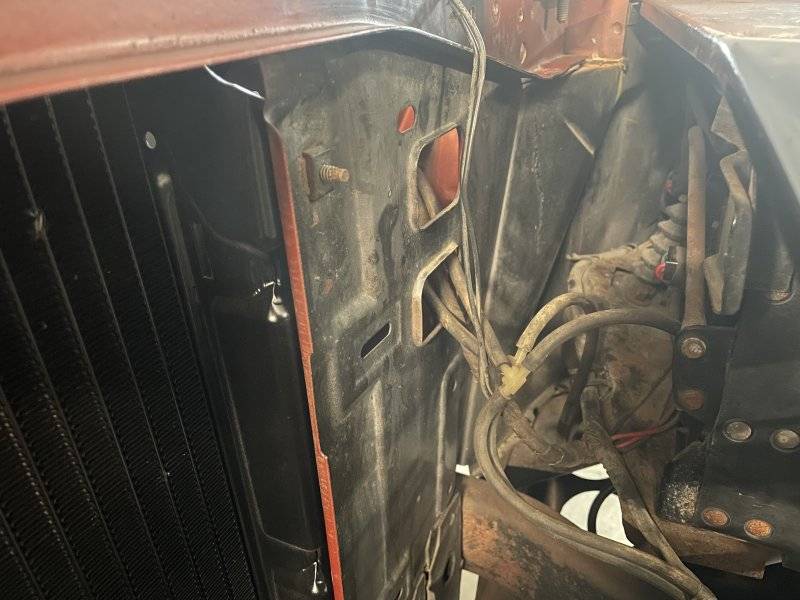

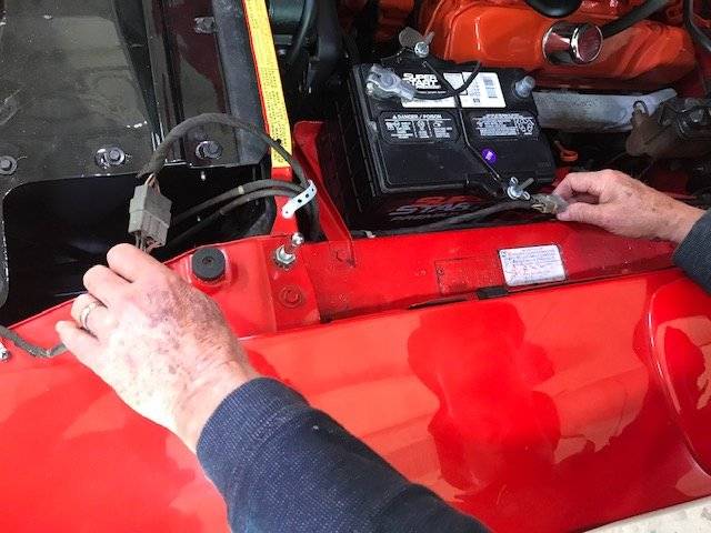

I'm having a problem finding the short 14-inch wiring harness used to bridge the fire wall bulkhead head light wiring harness to the front head light wiring harness. See pictures. The first picture shows the wiring harness on my 69 Daytona as an example of the short harness. The second picture shows the 69 Charger that needs the short (bridge) wiring harness. Thanks for any help. Jim in Napa

1968-69 dodge Chargers use a short harness from the Bulkhead to the grill wiring harness which is for the headlights. About 36 inches long. I have that harness. seems to be different on the pictures of Daytona's Bob Horman
My 69 Charger R/T doesn’t have a bridge between the bulkhead harness to the headlight harness.

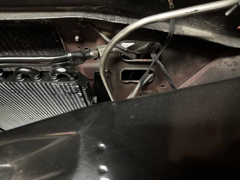

Does the Charger actually take the vac and harness over the rad support, or through it like all others.... other than Superbird and Daytona?
I believe the headlight wiring in the top hole, vacuum lines in the lower one.
Since the Daytona is 90% the same as the 69 Charger, I am restoring I've been using it as a example to follow. Thanks all for pointing out some differences between the two Chargers.

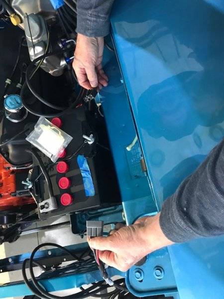

Here’s how both of my survivor 68 cars are routed. My buddy’s 69 is the same.
