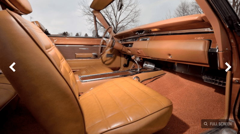

Hello! I'm in the process of restoring my fathers 1969 Sport Satellite convertible and had a question about one of the interior colors. The color in question is for the the steering wheel housing and also for the steering wheel itself. I'm pretty sure that the color of the interior is called "Saddle Tan" but wanted to make sure before I ordered the wrong color spray paint! I've attached a photo of a '69 GTX with the same color interior for reference.

This has to be made in a lacquer. This is the Ditzler code you'll order 23076
SUEDE FINISH COLORS
Used On:
(a) Instrument Panel. Steering Column and Components. Windshield Garnish. Rear Window Defogger Bezel.
(b) Convertible Header and “A” Pillar.
(c) Glove Box Door-Inner.
Satin Black AC38VX9 9324 abc
Baltic Blue Metallic AC39EB7 13705 ab
Chestnut Tan Metallic AC38ET8 23076 ab
Bayou Green Metallic AC39EF6 43925 a
Regatta Red AC38ER8 71688 a
The steering wheel appears to be a "wood grain" wheel and does not get painted with the above paint.
