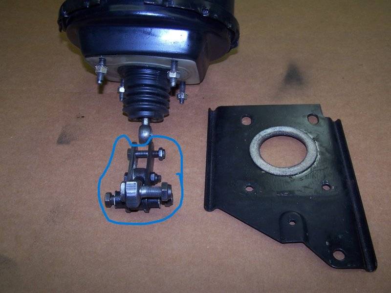

If you purchase the booster, backing plate and knuckle, The knuckle assembly gets mounted on your brake existing brake pedal. that is all that needs to go under your dash. You can then do your disc swap when ever you want. Circled in the pic is the part you need to install under the dash. You need to purchase the dual diaphragm booster though.
