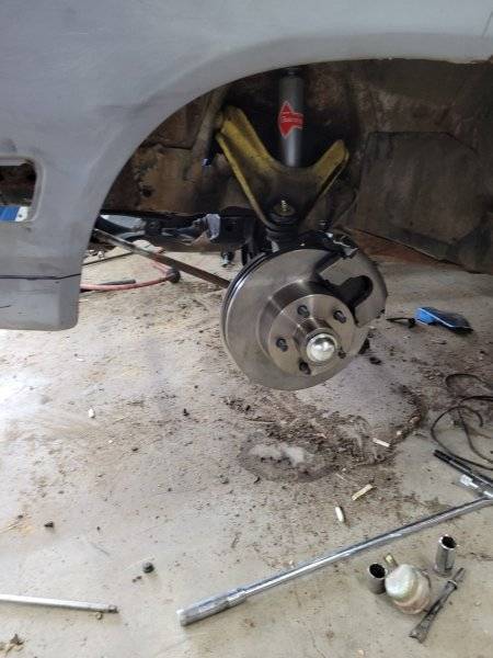

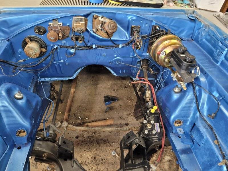

Pictures just because I know you guys like pics :) nothing to do with this matter(s) (3rd and 4th pic are warnings about hidden rear subframe rust to the knowledgeable eye, PO told me "just trunk pans needed"(in the trunk area) :) I have to laugh or I would cry, was about an unexpected cost of $7,000.00, parts and labor, I hope this might help someone else out, that rust seeps to the top of the sub frame without rusting out the bottoms of the frame rails, because of the holes in the bottom of the sub frame, I think. I like to give back to the forum :) On the plus side, the whole rear end is new except for the trunk lid, valance and right quarter extension.
