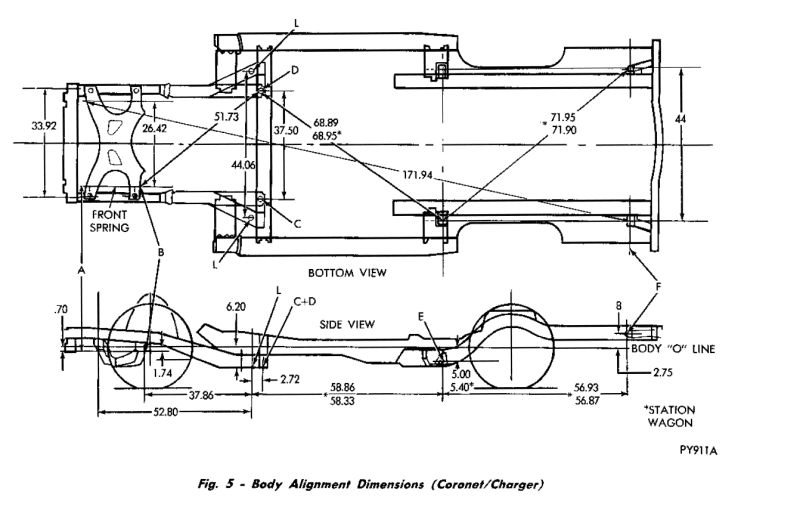

Does anyone have the datum drawing for the 71 Charger SE?
Getting ready to start restoring it and I’m building the frame jig. Will need to do some rear frame work to the old girl and want to get it back where it’s supposed to be.
