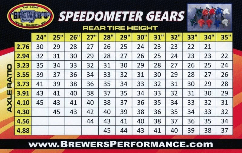

Hi all,
can anyone tell me how to correct the speedo accuracy on my 71 GTX? I don't have a tach but when checking the speedo reading vs actual speed, I'm about 15-20 mph faster on the speedometer. Assuming I can change the speedo gear to gain accuracy? Also I have 255-60-15 tires that measure just over 27".
Any help is appreciated!
It is possible to bypass the problem all together. Speedtech makes a gps driven stepper motor that then drives your Speedo. Very accurate
appreciate the info but I'm a stickler for original. Will try and find the correct gear to correct the issue.
