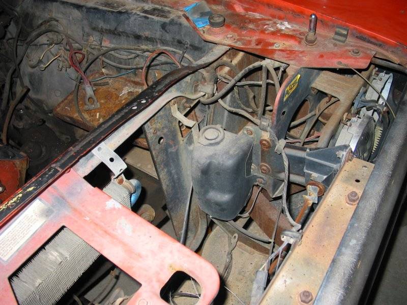

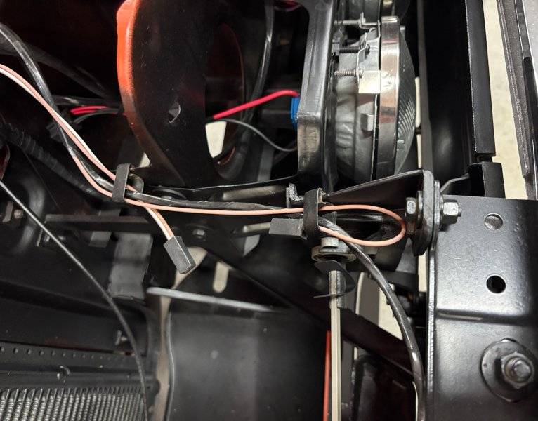

I drug this old 71 SE up from Oklahoma. .very solid car but sat outside since 1979. .car was traded off at a local dealer and the dealer took the car to his farm and there it sat since 1979. .it looks pretty unmolested except for the wheels someone must have put on it back in the day. .the mice have ate the plug wires and the wire pigtail I have in the pictures. .just wondering what some of these wires were for. I don’t see where they would have hooked. .maybe an option it didnt have? Shows 42,000 miles. .I’m trying to decipher if that’s original or not. .anyways in the first picture there are two wires ate off which join into one female terminal right where the headlight harness comes thru the firewall. .2nd picture shows a wire with female end just dangling there from the harness that actually goes to the headlight bulbs. .what would that have been for?

The headlight motor ground wire is hooked up. The wires in question do appear to be brown with a white tracer. Two wires going into one connector and one wire by itself not hooked to anything
Windshield washer motor wire is brown with no tracer but, if I recall correctly, should be driver side. Front end lighting wires are black, red, and violet with a tracer. Right fender top turn signal indicator is black with tan tracer, left fender indicator is black with a light green tracer. Headlamp motor ground should come from a common splice with the headlight wiring. Power to the motor is black with red tracer and dark blue with yellow tracer. Right park light is fed by black with tan tracer and black with yellow tracer. Right marker light is black with yellow tracer and black ground. Left park light is black with yellow tracer and black with light green tracer. Left marker light is black with yellow tracer and black ground. Service manual shows headlamp wiper feed (brown w/tracer) should connect to the instrument panel wiring with a bullet connector with a solenoid between the connector and the wiper motor.

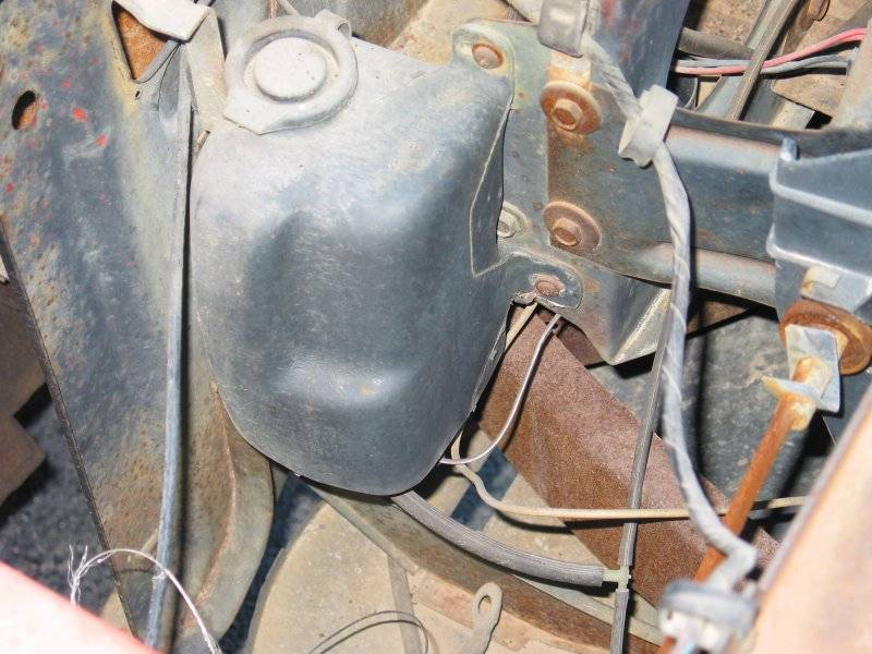

The single brown with a tracer is the headlamp washer motor, the two browns connector go to the washer solenoid(mounted near the hood pin). Here you can see the solenoid and washer reservoir. If not equipped the wires are loose like on my 71.
