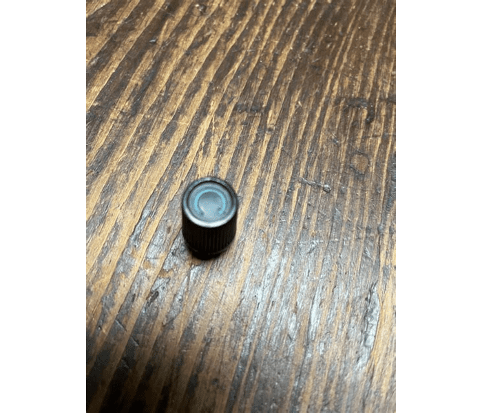

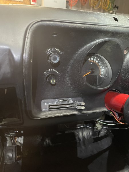

My reply got deleted but 70-4 E-body ones work fine as it clears the recess enough. There was one on a '73 Rallye Charger when I bought it. Looks like this..

really? thats great! let me look for one. how does it attach? assuming it has a half circle shape or circle in the back?
Yea it has the same size 1/2 moon cut out and metal tang as an original b-body one..
All round Mopar wiper switches of that era are basically the same (including the half moon cut for the knob) just changing the lenght of the shaft itself to accommodate to the right cluster…
Pre 71 switches are diff on the diameter size and prong disposition for the plug on rear from post 72, but carrying same wiring and functions.
Aren't "pre-71" B body wiper switches rocker switches?
Yes for 68/70 B and C bodies, not for same years A bodies. Hence why I said round. Obviously excludes the rocker kind.
