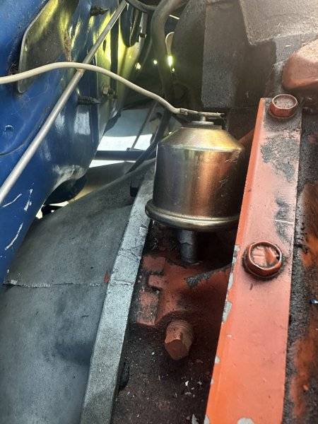

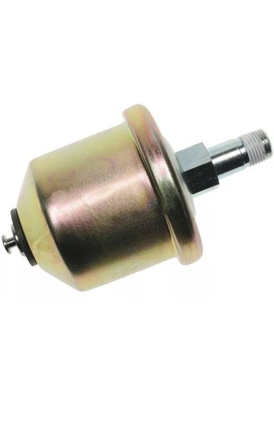

Hi all. Trying to swap out the oil pressure sending unit on a ‘73 RR 400. Issue is the 9/16 wrench fitting has been rounded off before i “inherited” it. Any creative ideas? I tried to get a 14mm wrench on it, but wouldn’t slip on. Didn’t try any “gentle” persuasion yet. Wanted to ask first. See pic for photo of type of sender im working with.

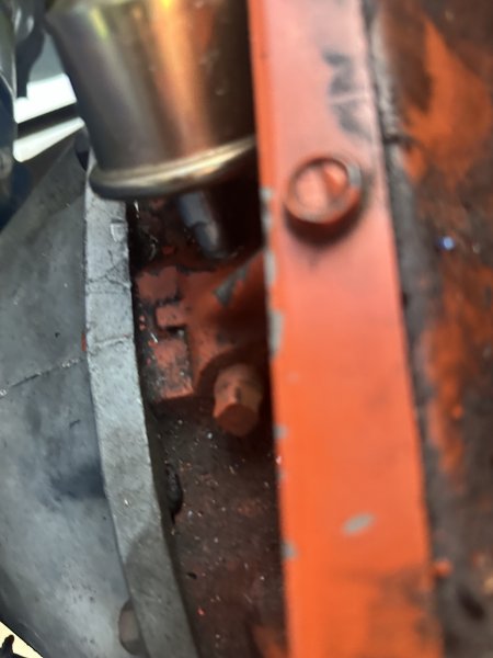

Hey all. Tried a strap wrench and vice grips. Strap wrench got the top brass dome to spin. But not the shaft. No love with the vice grips either.
Thinking may have to seperate head of unit from shaft and then easy out the shaft?
At this stage, I think won’t matter destroy the top part to get all the piece removed… in pieces LOL.

Agreed. Unfortunately its going to be 105+ in So-Cal this week. So breaking it apart will wait for a cooler day.

Gave it a good soaking yesterday. If tbe forecast pans out, may be breaking this unit apart & getting this done once and for all this werkrnd.
