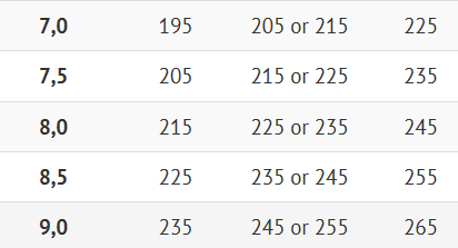

Think of it this way. Same width tire, with same backspacing will move the tire outwards the inch you widened it. 69B3RT is right though that if you are going with a wider wheel, you may want to go to a wider tire. 215 is a pretty narrow tire for a 8" rim. According to a chart I found, you would be right at the minimum tire size for a 8" rim. 225 or 235 would be better! Still need to look at your backspacing though so you can center it up in the wheel well.
Oh,.. just realized I lost the headers when I snipped that portion of the chart. First column is rim width, then min tire size, middle is ideal tire size, last is max recommended tire size.
