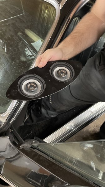

I recently ripped out that old, rotten football-shaped speaker from the center dash console.
I replaced that with a self-made bracket and 2 x 3,5" speakers from Alpine.

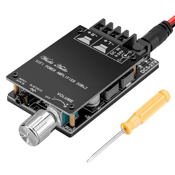

In addition to that, I added a small bluetooth-capable amp under-dash with 1 volume knob for controls (one of those chinese pcb-amplifiers):
In conclusion, the sound coming from this combination is absolutely horrible.
Are you aware of any good-sounding replacement speaker for the center dash console (preferably available in Europe) and a nice bluetooth amp that is small enough to be hidden somewhere under the dash?

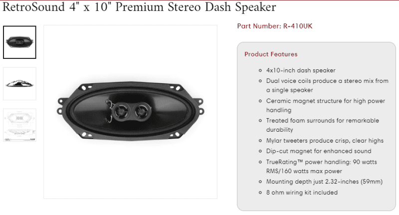

Below is a speaker that will help. It is from Retromanufacturing.com
No, I don't work for them and any similar speaker will help as well. The bottom line is you need to move more air to get bass sounds. Even the speaker below will have it's limitations - it is simply a function of size. You need size in order to move air and create bass sounds. But it will help.
(Note also: bass sounds are not directional, so you don't need stereo bass speakers. You could also install one subwoofer system in your car to get some better base sounds in addition to the above to help - these can fit under the seat, for example.)
