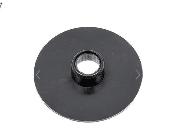

All I need are the grommets that go through the holes at the bottom of the door glass.
Is this what you're looking for?
I know it's made for a GM, but it's reproduction nylon.
Yes, it is the same idea. It is actually a better design than the Mopar version. I will probably have to take the glass in to a glass shop to see if any other brand of sleeves fit tight through the holes in the glass and still fit tight around the screw that holds it to the internal assembly. There is a guy in Phx (2 hrs away) that says that he has a box of used random window parts from different old cars that I can rummage through. I will probably take a leap of faith and buy the kit for the A body. Thank you.
