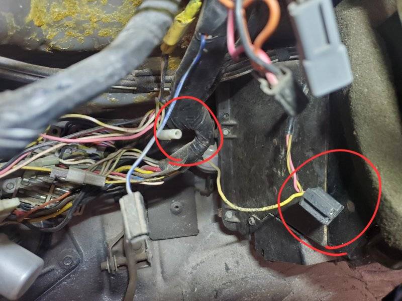

Hi everyone! I am finally reinstalling the dash on my 1974 Charger SE! I've been able to figure out most of the wiring, but I have a few mystery plugs. Does anyone know where these two belong to? They are positioned behind where the radio will go, but the radio plugs are accounted for. Thank you!
Pink and yellow are courtesy lamp circuits. That may be a timer connector.
Mike
The pink and yellow three wire connector go to the accessory lamp in the dash pad above the gauges. The tan round connector I am not sure of, it is not connected on my 74.
Mike
Thank you! I found a diagram that shows that one being for a time delay relay.
Awesome! Thanks!
