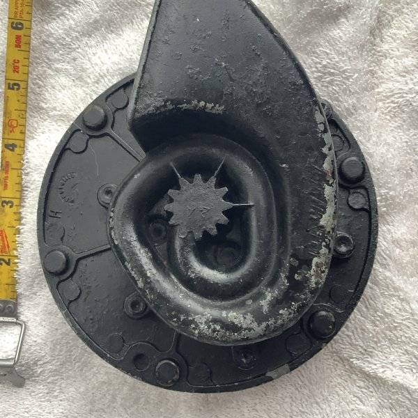

Does the 74 Charger horn have the same partno regardless the brand of the horn?

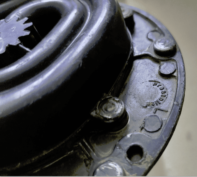

- I only have one Prestolite horn on the left side (L=low?), but I can see (bolt damage and wire split) there was one also mounted on the right side once, but has gone.
- What's are the partno's for left and right?

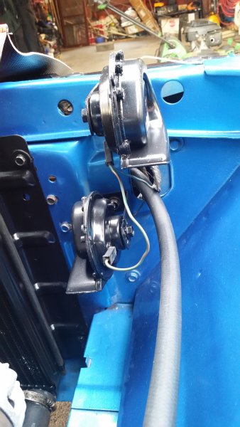

Does it matter? Sounds like you need a H high tone. Horns are oriented differently, maybe someone can snap a picture of your year, and right or passenger side. It can be fun finding the right oriented one. Went through this with my Dart!

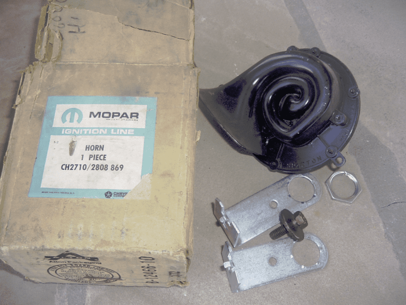

It looks like the kit has brackets and a proper bolt. If you want 2 tone, find a (H)igh note Prestolite and bolt it on. Where's the factory harness? My 2 Darts are both on the passenger side but I don't know about your car.

Just bought an original right wing (H-tone) Prestolite horn! Exact match to the Left wing (L-tone) one. :bananaweed:
