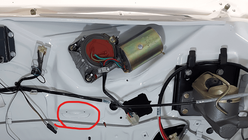

You can access the linkage by taking off the cowl vent screens.
While your in there make sure the drainage port is not plugged by debris.
The drainage port is under the wiper motor and drains down the firewall in the engine bay side.
Here's where its located on my 71 (circled in red) - your 74 will be similar.

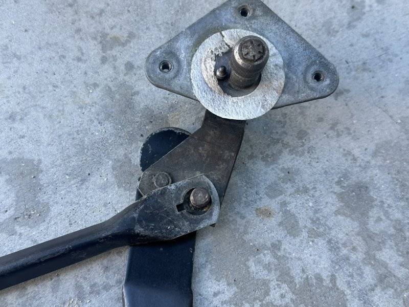

BTW what is the long arm that protrudes out on the drivers side wiper arm for?
It's a linkage arm that pivots the wiper blade so it is parallel to the vertical A-pillar when the wiper blade is at its farthest travel.
If that linkage wasn't there the wiper blade would not be parallel when going its farthest travel - it would be on an angle just like the passenger side wiper blade does.
Thanks. Mines broken. Guess I need to fix that too.

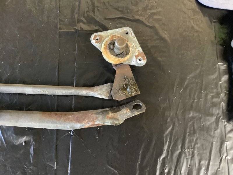

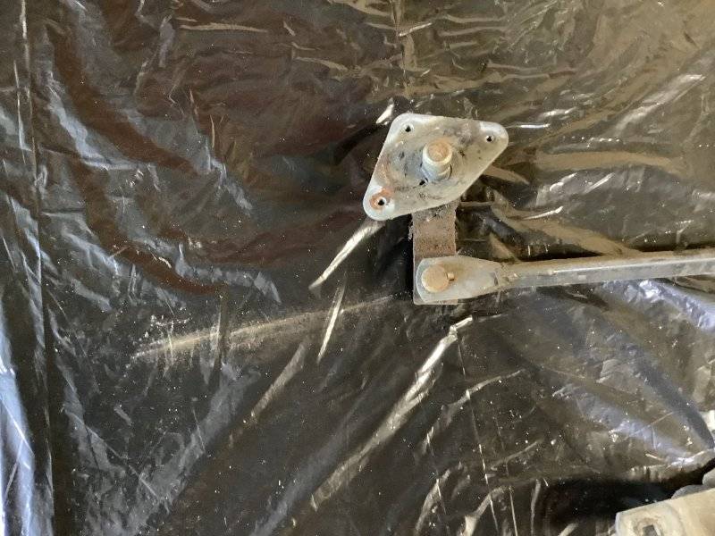

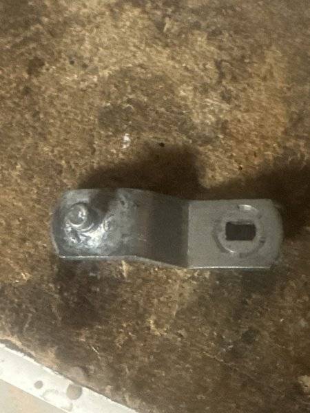

Hey Bbody knowledge base. I’m taking on the reinstall of the wiper linkage in a 73 Road Runner. Got the parts ready to install. Brother in law (PO) never installed them.
Before i battle them back in. Can anyone confirm if they are layed out right?? Especially the driver side pivot. Which tab does linkage to motor go to?? As laid out? Or swap the two??
Also is taking out the wiper motor and taking off the linkage there the easiest method to install?
Thanks from socal. And bushings are not in pix.
One more clarification B-hive. Which way does the bracket to motor face?
