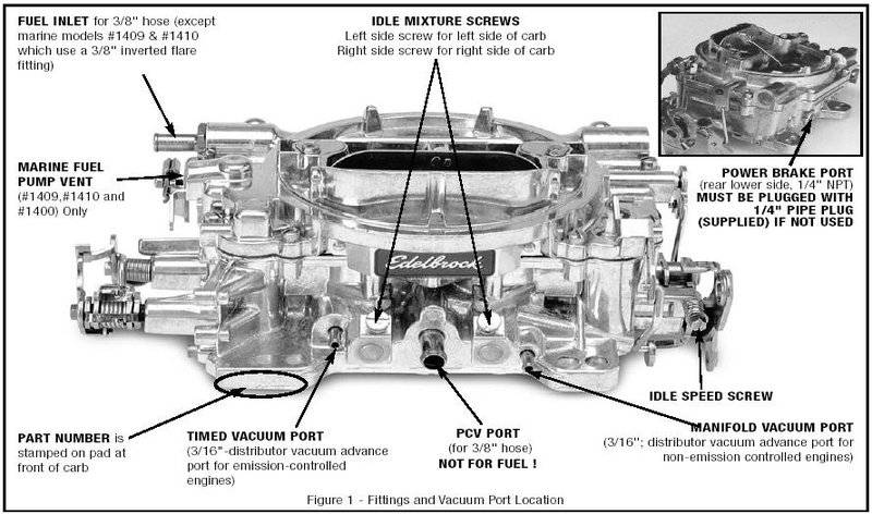

I am trying to reconnect my tank evaporator/canister to my 1906 AVS2 but there are not enough ports. There are 3 ports on the front "ported vacuum", PVC, and another manifold vacuum port. I have searched and found that the "Carb" port on the canister can be plugged or connected with a T to the PCV line as the 1906 does not have a bowl vent connection. The "Purge" needs ported vacuum but I do not have another "ported" port to connect it to. I dont think it would be wise to T off the only ported port connected to the distributor.

The little vacuum ports on the front are for the distributor vacuum advance, the one on the passenger side is for emissions controlled engines the other one is for non-emissions engines.
Yes and from what I read the passenger side "emissions" is ported and the drivers side is continuous vacuum. Everything I read is that the "Purge" connection on the canister needs "ported" where it only gets vacuum when the throttle is opened.
Currently, my distributor is connected to the "emissions" port (ported) and the "non emissions" port is plugged off (continuous vacuum).
My only options are to "T" off the "emissions" port or get some type of vacuum switch that would switch on and off with the throttle. I don't think it is a good idea to "T" off my distributor port.

If you are going to run that carburetor you might as well cap off the canister. That is a non-emission style carb and is not designed or ported correctly for emissions. It needs a bowl vent which it does not have.
Have you tried the distributor on the non timed vac port?
I did not buy or install the Edlebrock, I got the car with it. I would like to put the TQ back on with the Lean Burn to be honest. Can somebody verify the way "the canister" works? What exactly does the "purge" port do?
