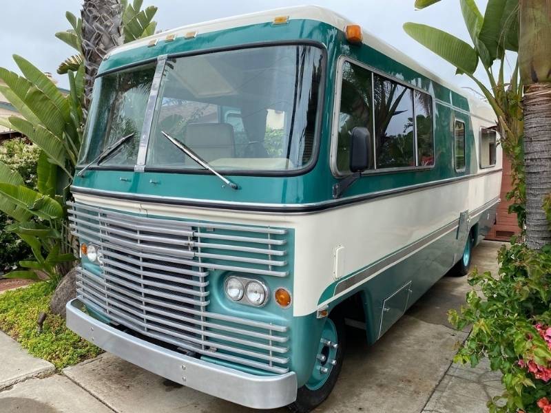

This is not ours but looked like this. I have old pictures of the Avco but I was a kid and wouldn't know about the drivetrain.
looks very aerodynamic :rolleyes:
It was a brick on wheels but it was the only Motorhome at the time that would fit a wheelchair through the door. I think it had a 32 inch door. Might have been 36 I cant remember but I was a kid then so....
