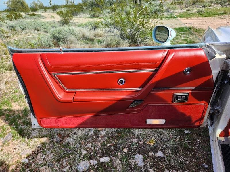

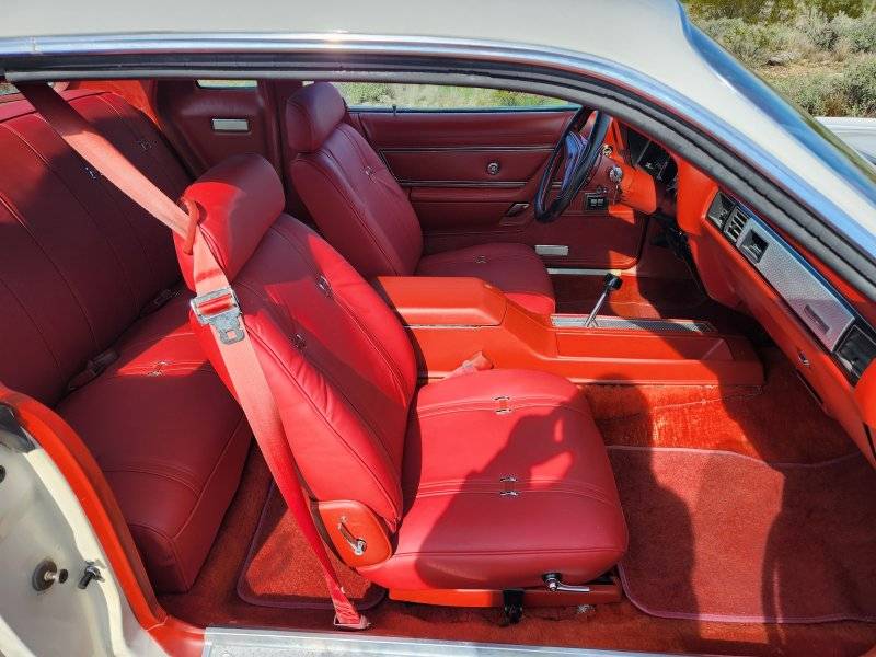

Has anyone had any luck locating a spray color compatible with the red plastic interior of the 1979 Chrysler Cordoba 300 series? I have looked at SEM and Duplicolor Vinyl and Fabric Spray Coating, but each have various shades of red available. Trying to figure out the proper color instead of buying multiple cans of different shades of red and experimenting.
Thanks!
I redid mine with SEM Firethorn. Not a perfect match but I resprayed everything so I'm very happy with it.
Yep, SEM from a paint shop that matches color well. Take an example of the color to the paint shop
