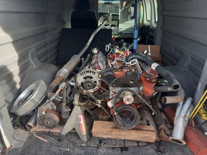

I am helping my son rebuild a '96 Magnum for his 74 Road Runner, but all I can find are books and information on the earlier (flat tappet) 360s, and very little on those.
Although the block casting # is 53020006-360 which shows to be a 1993-2005 block.
This engine was given to us for his car, and was thought to have come from a truck. Actually, when my son tore it down it was clean. I am talking gold oil in the covers and pan, and very little signs of wear. I took it to my friend at Brand Engines, and he recommended just a rebuild, so he vatted, honed, installed cam bearings, and polished the crank for us.
This is where I began my learning curve on the 360. I discovered after buying a new set of rings that I needed the 92 and newer 1.5mm and 4mm rings, not the early larger width rings. Now I own a set of Seal Power E-251X standard rings for the 71-76 360s. Before I venture off to newer territory to spend money, I want to get my hands on an actual manual for this series engine. This is my son's first build, and I would like for him to learn the why and how to use a manual too.

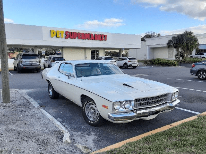

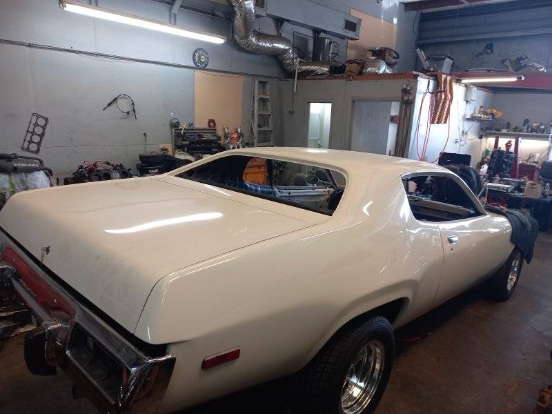

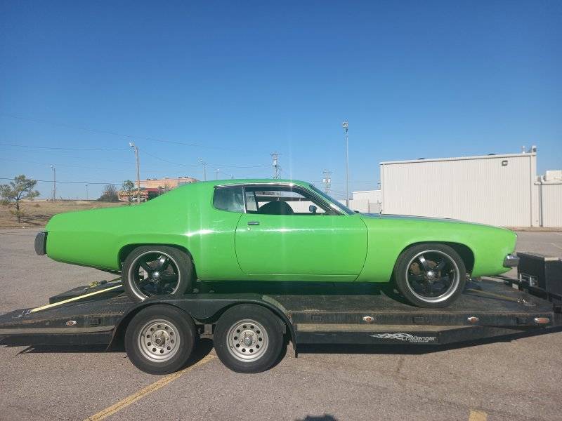

What did you do with the side molding from my car??
...and how did you get my car?
Do I need to go look outside?
Cool, YY1 you have one clean machine.
I tried to buy the car too. It was very clean and since it needed an engine, tranny, and finishing up the interior, I figured I could get it cheaper. You know, a good friend deal.
