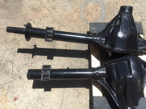

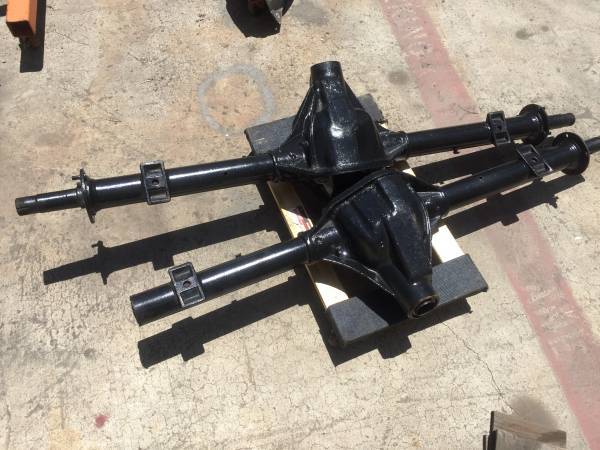

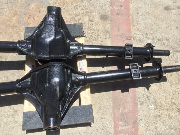

Found these while looking in Arizona craigslist.. Killer price.
https://sandiego.craigslist.org/esd/pts/d/el-cajon-dana-60-axle-housing-body-body/7003294367.html
From the ad.
Hi there,
I have one Dana 60 Axle Housing.
Only the cut housing is available.
This is the housings ONLY, no Third Member.
This is correct for 1966-1970 B-Body Mopar such as Dodge Charger, Plymouth Road Runner, Coronet, Satellite, Belvedere, GTX and Super Bee.
You can move the leaf spring perches to fit E-Body Cuda and Challenger as well!
- In overall good used condition.
- Have been cleaned and painted.
- Ready to go!
Asking $150 per housing.
Please call or text show contact info .
Thanks so much!
Those are truck housings, fine if your doing a four link but no mount for a pinion snubber if your using leaf springs...
Ahh damn it said they were for a bbody.. Im not familiar with the DANA stuff. Just went by what the guy says in the ad. Sorry to get anyones hopes up.
Hey, you were willing to share, Thats worthy of a thank you... No reason to feel bad... Lots of truck Danas have been cut down & used, but either you fabricate a snubber mount or you us a four link or ladder bar system...
Those housings are gold!
I shared link with a friend he will most likely buy them he cuts them down and makes a snubber Mount ! Builds them out and sells them . Only so many real Dana's out there and everyone wants one !
Good looking out
Point is that's not a B body Dana. A Dana 60 is a Dana 60. If you want a Mopar Dana 60 it's machined for a snubber & the spring perches are on the bottom. I haven't used a snubber on my drag cars since '75. Proper spring combo makes the snubber unnecessary.

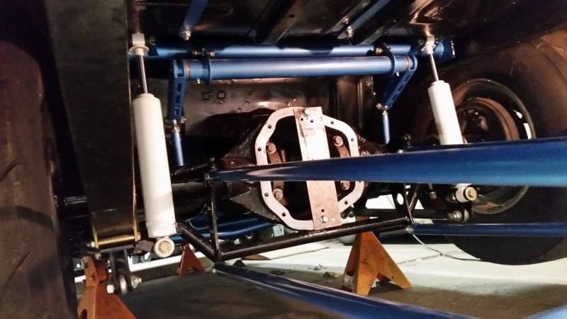

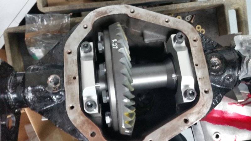

I narrowed a 1 ton Dodge truck rear axle Dana 60 in my Challenger. Caltrac split mono leaf car so no snubber mount needed. I added supports and wheelie bar brackets just in case.
