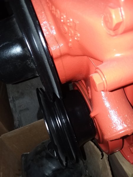

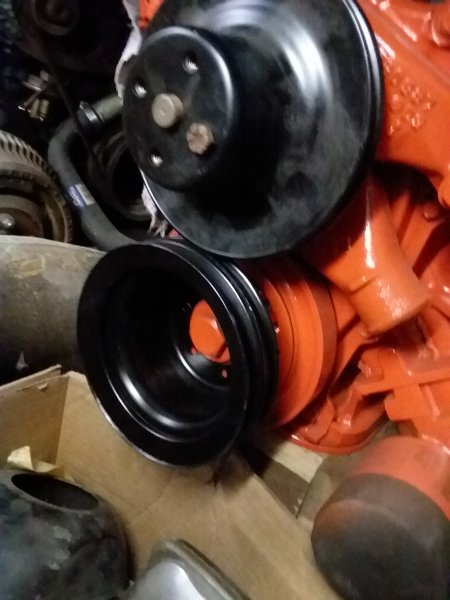

i was told in order for the power steering to work both double groove pulleys should be the same diameter on the fan pulley and the crankshaft pulley? PM me
No. On BB mopars with no A/C 1969 older both grooves were same diameter. 1970 saw the PS groove larger diameter. They both have the same offset. So with the right length belt either would work.

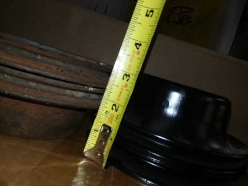

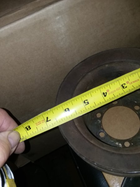

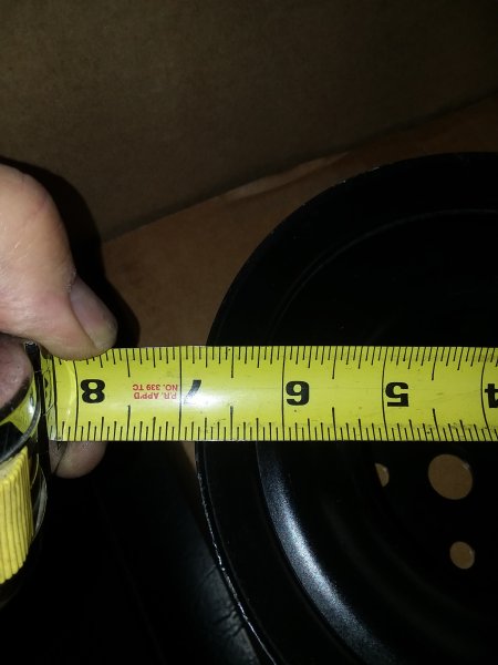

i currently have a 6 1/2 inch diameter pulley for the fan pulley and my crankshaft pulley diameter is 7 1/4 on my 1970 440 motor
Then you should use an early style lower pulley with the ps belt wider than the than alt.
I probably have more than one. PM me

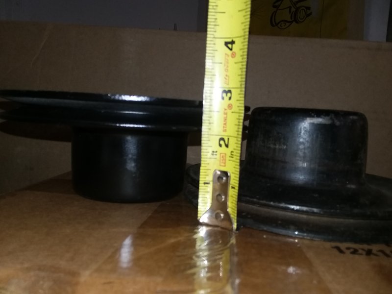

You must have a small block cast iron water pump pulley on it.. Any issues with the water pump bolts?? Those pullies look similar to big block but the big block is 2 3/4 in high 6 7/8 wide and the small block is 2 5/8 in high 6 1/2 inch wide
There is more than 1 size of bb w/p pulley’s that are 2 3/4 deep. U actually should have a smaller diameter w/p pulley to speed up the w/p so it will run cooler. Or a bigger crank pulley. Kim.
My Bad. Yes there are different w/p diameters I thought this was the guy (it wasn't I re read what he was asking) who was dealing with pulley alignment on the water pump to crank pulley I recently read somewhere... I have seen many over the years trying to use the typical BB w/p pulley and it ended up being the SB one...

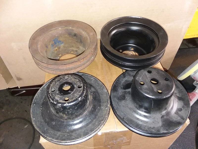

Ok, here are the correct pulleys for a 64-69 big block. For the offset bolt pattern harmonic balancer, wide ps belt.
I have dirty set and a blasted and epoxy primed pair.
I have the same for later balancers that have the one bolt hole elongated.
