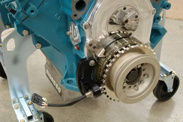

I used
the billet one from Mancini Racing on this EFI engine.

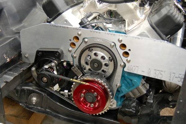

This is a very stable setup. Belt drive, crank trigger and cam sync. No distributor with sloppy bushings or jitter from the oil pump, just a nice clean digital signal.
