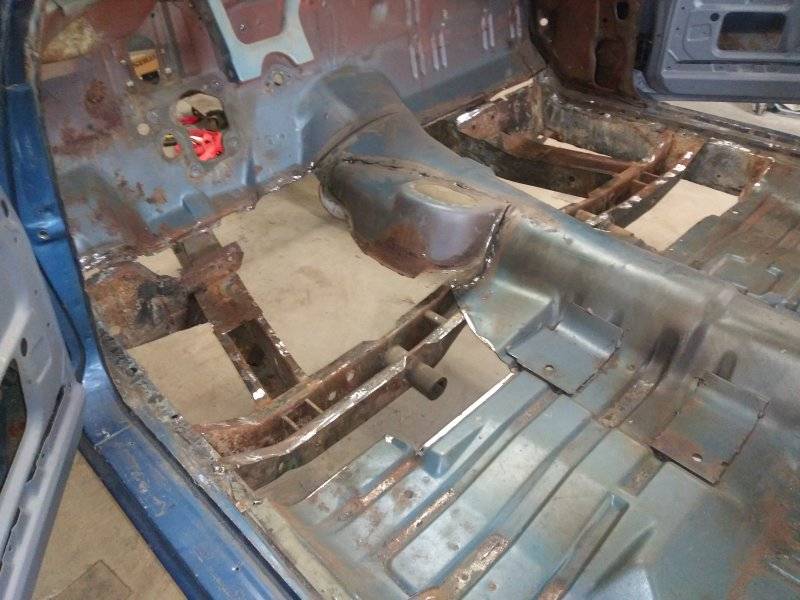

On 68 Charger w bucket seats, where do the seat belts get bolted to the floor? Are they attached with seat bolts, or separate bolts?
Should there be some sort of metal plates used under floor holes as “washers” ?
On roadrunners they are a separate bolt ( see post above from Richard cranium looking for one. Has photo.) they attach into reinforced threaded holes in floor pan on tranny tunnel and next to the sill plate
I did find the 4 threaded seat bolts holes…. Now just wondering if there is supposed to be any sort of reinforcement “plates” under the floor for the seat bolts?
The seat belts have a bolt that goes into the threaded holes. The seat bases go through the floor with nuts on the bottom
Understood…. But just the nuts? No giant washer type metal plates?
bucket seat cars have reinforcement plates over the inner holes on the inside
