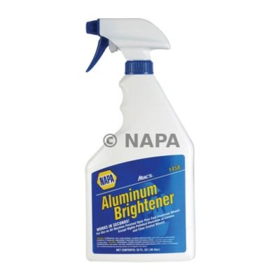

As far as cleaning the manifold- this has worked really well for me:
Keep the brightener away from polished parts and paint. Otherwise it works well.
Doug
