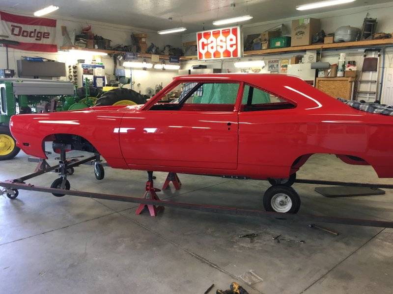

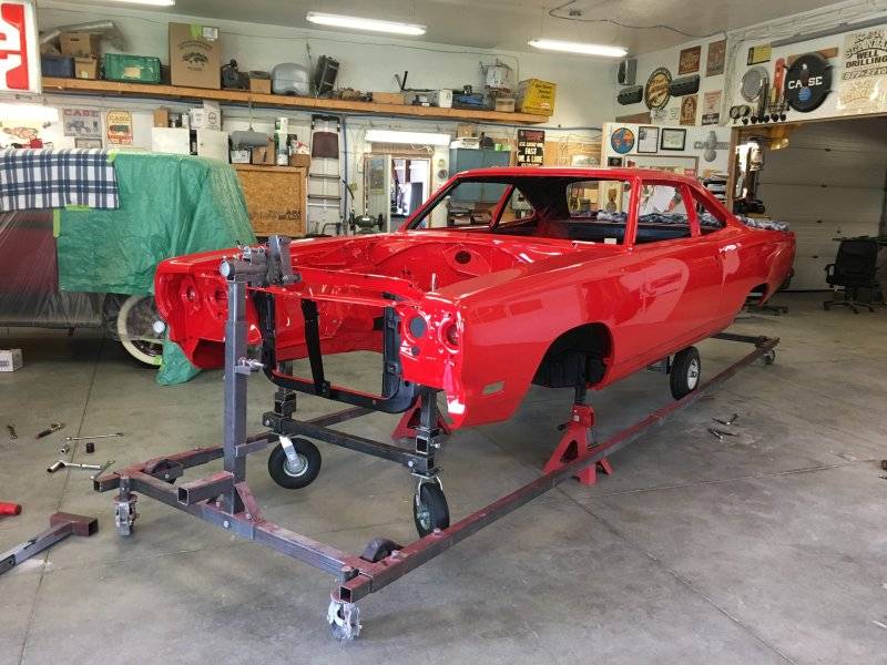

Pic for reference
No idea, the guy’s main business is restoring farm tractors. But he’s an awesome body man and painter.
