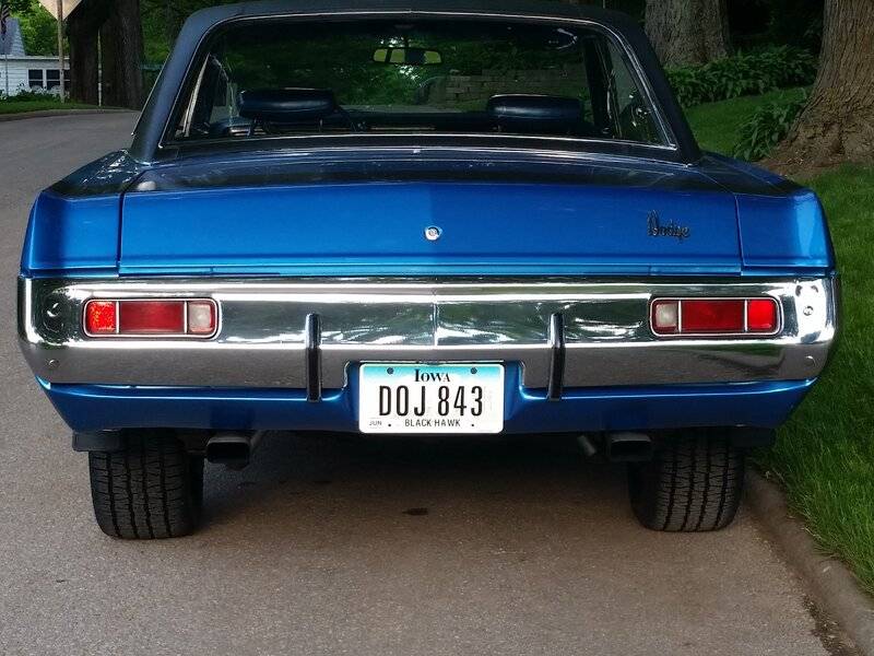

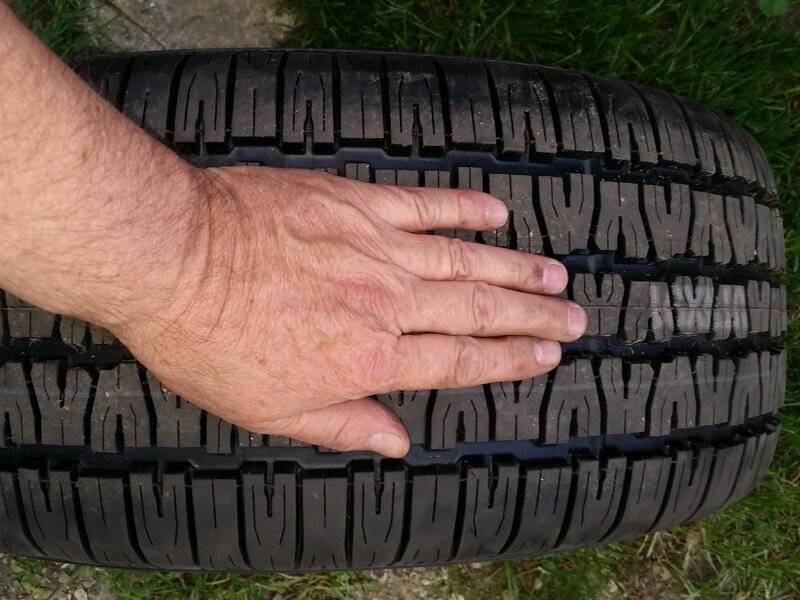

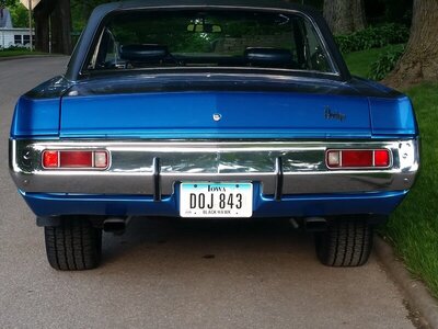

Yea, most of the tires I’ve looked at say the 7” is minimum for a 255x60 and maximum for a 215x70 that I am thinking of for the front. I want to get a new set of wheels/tires before the season rolls around and looking at options. Started by thinking I’d get all 7” wheels since it seems to be a more or less ideal size for most rubber combinations that I’d run on this car or most others. I currently have 8.25x14 bias ply tires that have an OD close to 27.5” so I started there trying to find a front tire that was close to 27” OD, that’s where the 215x70 came from. Then I got looking to see what I could get away with on the back. Actually a 245x60 would probably be better on a 7” wheel but they are a bit under the 215x70 in diameter while the 255x60 is a bit bigger…. Quandaries!!

I’m thinking I might drop to a 245-60 for the back. The car is not a hot rod so there’s really no need to go overboard on the width.The Cooper GTs 215x70 is 26.7”OD and their 245x60 is 26.6”OD so they are pretty close. 1” difference in tread width just enough to be noticeable. Now to find the best deal!
