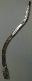

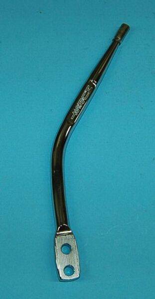

Ok all, looking to use a woodgrain knob in my 68 Roadrunner, but all the knobs use 3/8-24 fine thread and all the bolt in shifters that are offered for a non console car use a 3/8-16 course thread. Any way to adapt this or has anyone found a woodgrain shift ball that looks close to the original and uses the course threads? I don't really wanna use an original handle and drill it out but I guess that is the last resort. I have the pistol grip in it now but wanna switch out the handles and try something different in the car for awhile. Let me know your ideas or solutions. I am looking at these handles but no luck on threads to match the woodgrain ball offered by all the resto sources.
