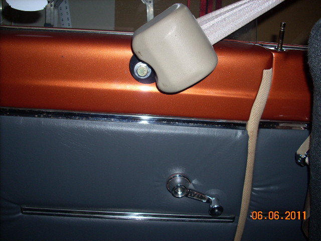

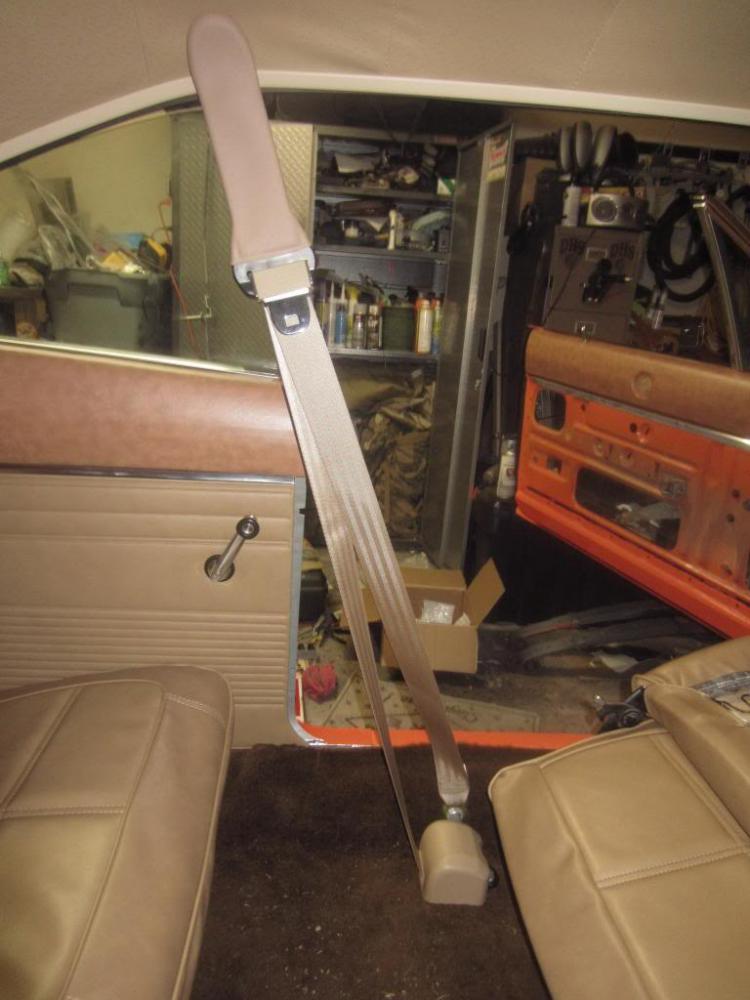

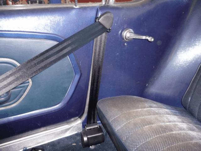

Here are a couple of example photos of 1 and 2. I couldn't find one for 3. SBelt1.JPGSBelt2.jpgSBelt3.jpgSBelt4.jpg

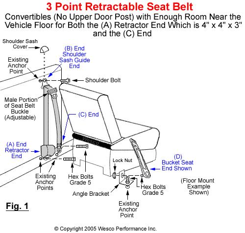

I'm steering towards option # 2 as shown in the Fig 1 diagram above, but with a slight mod. I was looking at the upper retractor part of the belt in my 2000 honda civic yesterday, which is very comfortable. It looks just like the Fig 1 diagram above except that it mounts 3-4" higher on the B-pillar that I don't have on my Satellite hard top. I'm wondering about mounting it like that on the rear window metal piece and fabbing up an adjustable riser with holes and pin like a jack stand (but hopefully nicer looking). This will create a better wrap angle around the shoulder than coming off from the ceiling. Thoughts and opinions of my approach?
