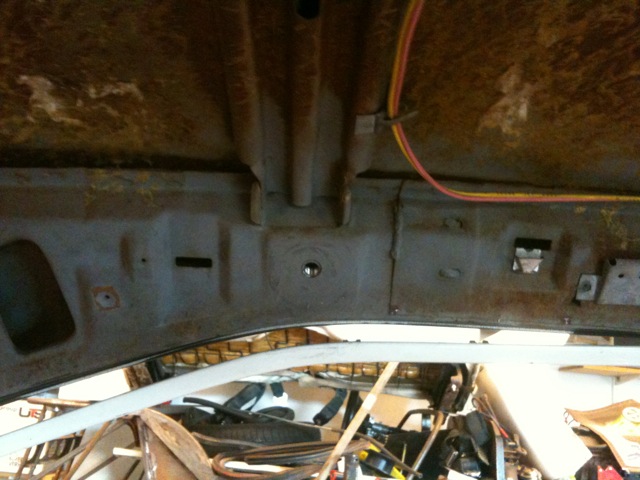

So I am getting ready to get the interior installed on my 70 Roadrunner and I decided that I would like to install 3 point seat belts in the car instead of just lap belts and don't want to install a roll bar to mount to. The car currently doesn't have a mount point for the shoulder part of the belt along the roof line. Was it optional? If so, where was it mounted? Does anybody have pictures of the mounting location without the headliner? I am open to ideas. Thanks.

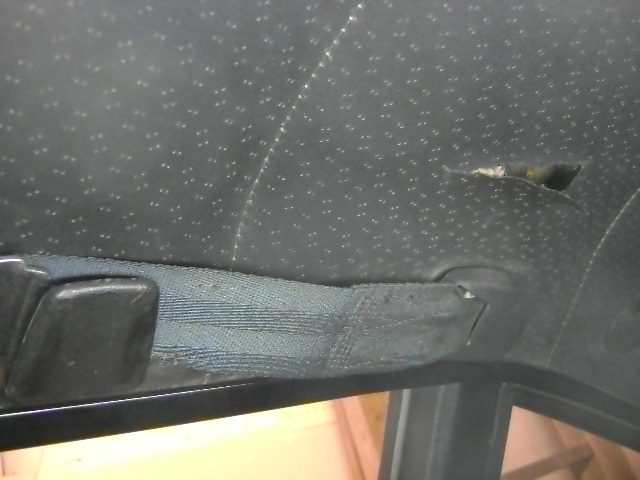

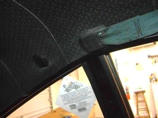

I have an October 69 build 70 Road Runner and it has shoulder belts for the front driver and passenger. I thought this was stock. Maybe somebody re-did the headliner and covered up the mounts on your car? I'll get in the garage tonight and take some measurements and pictures.

Forgot the tape measure but remembered the camera. Hope this helps. Hopefully you can look at the location of the clothes hook, then feel forward and find the hole for the mounting bolt.

Thanks for the pics. I have it. I feel like a dumb *** for not noticing it earlier. With the dash and seats currently removed from the car, I was looking further forward for the mount hole. After Greg posted his pic, I started to look further back. Swede, that is exactly what I found. Thank you for the pics guys. Humbly yours
