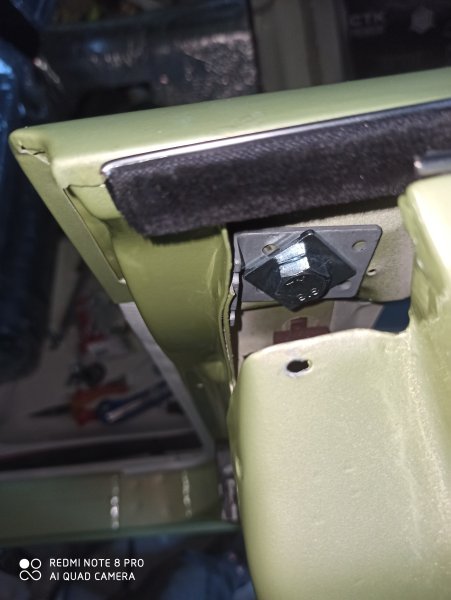

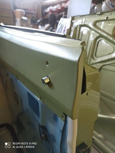

I am doing 3 point conversion for my 68 ht satellite. What i am gonna do is mount the shoulder loop in the corner of door jamb. I didnt want to install it into the roof rail. Picture where it will bolt to:
This will require reassembling the retractor and welding the shoulder loop shorter. This mounting placement will tilt the shoulder belt downwards so in case of accident it will break your collar bone/shoulder most likely..
However this seems to be only place to get bolt thru in hardtop in a somewhat structural place if not using the factory roof mounting location. In 68 most likely there is no factory nut ready in the roof structure so you will need to replace headliner if you want to use that mounting..
