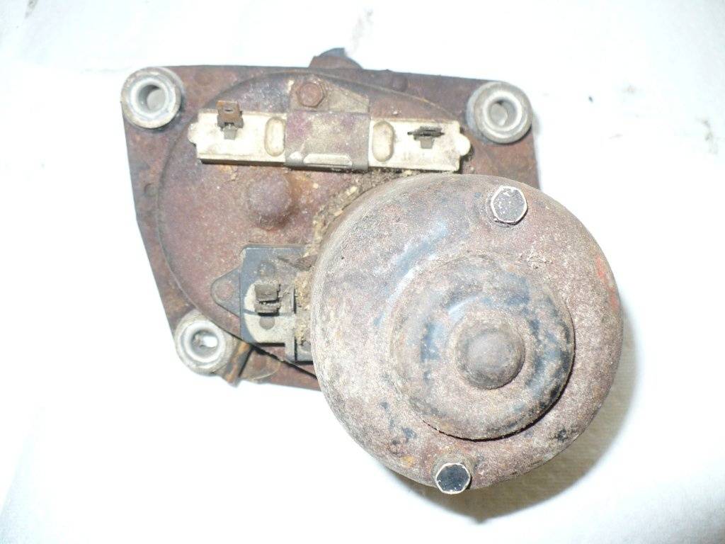

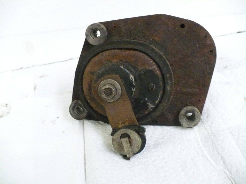

Is this a three speed wiper motor? Took it off my 69 Coronet 500, work when I removed it.
This "might" help you. My car came with 3-speed wipers and many years ago the wiper motor burned out. I found another one on a C-body, but the "rounded side" of the motor itself (makes sure the lever arm only goes on one way) was on the opposite side of my wiper arm (3" long piece that bolts to the wiper motor itself). I took a rat-tail file & rounded out the opposite side (so mine will now go on two ways). It bolted up and has worked for the last 20+ yrs.
