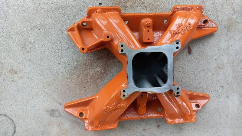

Interested on the intake as well. I used an indy on mine, had to get creative to seal it up. Won many a race with that, before she done blowed up.

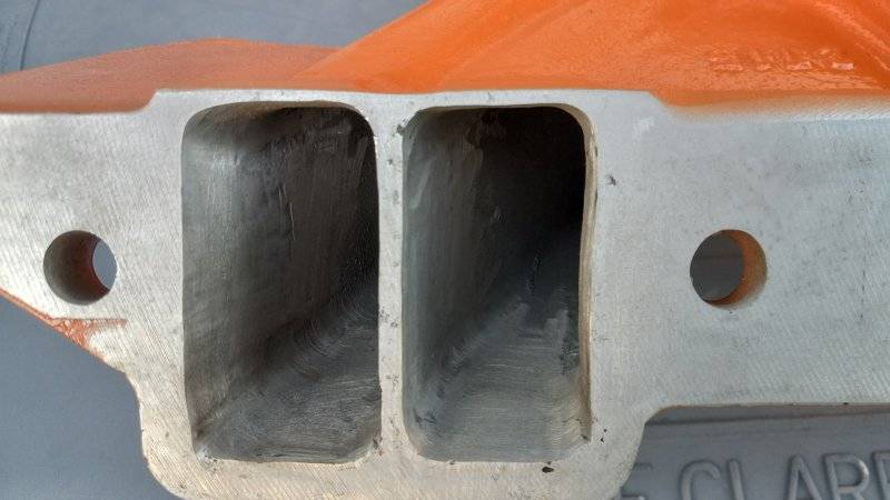

This is a modified TM7 that I picked up cheap, already welded up to use on a 440 with maxwedge heads.
The manifold worked well but sealing the valley was a nightmare. After several that I fabbed cracked, or didn't seal/leaked, I finally cut the top of the ports away on a stock bathtub, ported what was left to match the ports, add used hand-cut gaskets on both sides of the bathtub ports. That finally worked.
The tarantula ran exactly the same with a 850 dp, as the stock max intake with two 750competition carters
Found a pic of what I did. The bottom of the intake flange and the valley tray were milled together. And then the little corner wings
