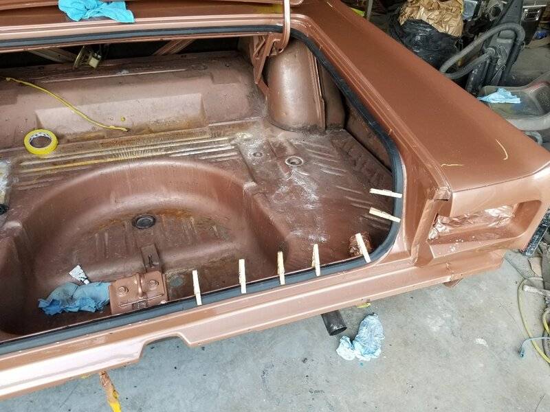

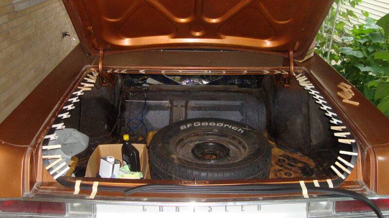

The 3M Weatherstrip Adhesive that I am familiar with doesn't take hours to set, just a matter of a few minutes. I use wooden clothespins on the trunk seals. On other things, yes masking tape can be useful if you don't want to hold it in place for a couple of minutes.
