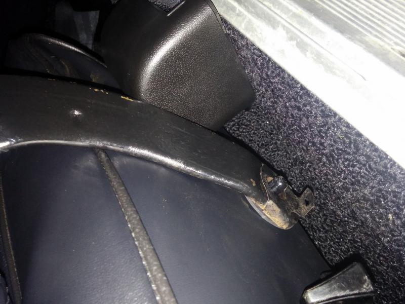

Here are some pictures of the retractor interference

Heard back from the company, so apparently SOME 68 b-body's had the outboard seatbelt hole more forward than others? Never heard this story before. End result is I will be needed a 6" Extender bracket to move the retractor back just behind the seat.

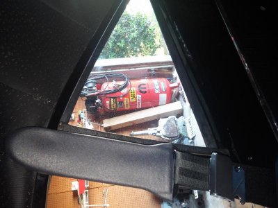

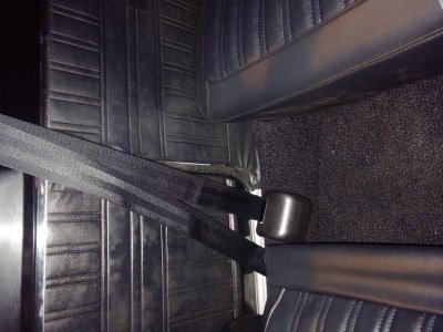

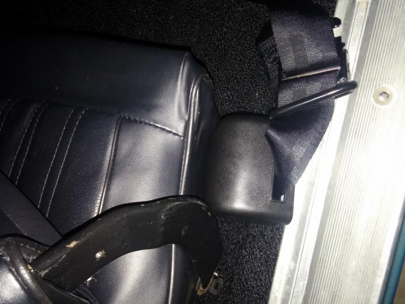

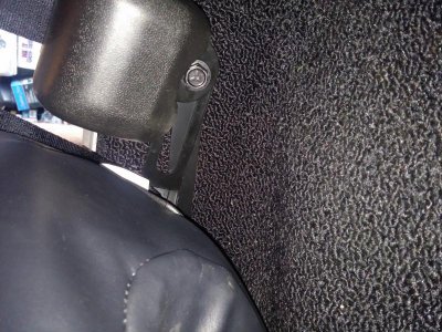

Here are some pictures. Sorry for the sideways view, don't know why that happens!

The extensions will work for me - just the ticket. They will stow easier and be less likely to twist. Don't have your skill, so I will buy some. I don't have the housing at window level. Makes it less noticable.
The belt position in perfect, and the B-pillar / post hides the belt pretty good ! ahh c'mom man, they were simple to make. 1/8" x 1" flat stock, holes are 7/16 and 6" apart from center to center. clean the metal up and prime / paint, easy job !
