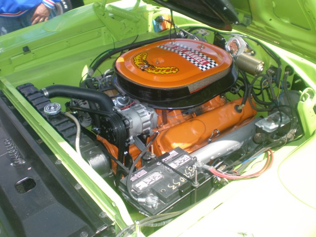

Having run six packs I can attest to the WOW factor from the looks, and the OH MY GOD factor when the outboards open up. Ain't nuthin like it. They are fairly easy to tune (and NO PROBLEM to KEEP tuned) when running them with a (close to) stock cam. All that said it would probably be easier to tune a big 4V with a monster lumpy cam than the Six Pack.
If it were me, I'd do whatever necessary to run the Six Pack.
i have had great luck with my six pac , and if i decide to go on a road trip to a car show , if i drive reasonable and try to stay out of the out boards , i get 18 miles to the gallon off that center 2 barrel .

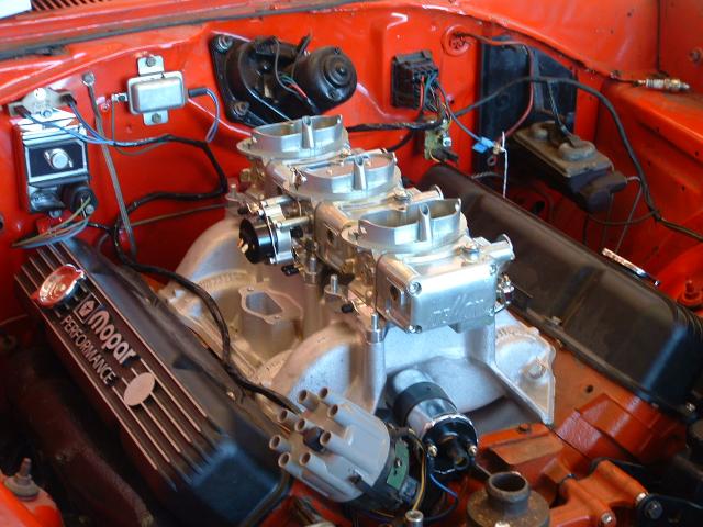

That Demon 6 pack is pretty. I'm the only guy in my club that has a 440 and no 6 pack. While my Torker and 850 DP are fun enough, I wish I had one.
