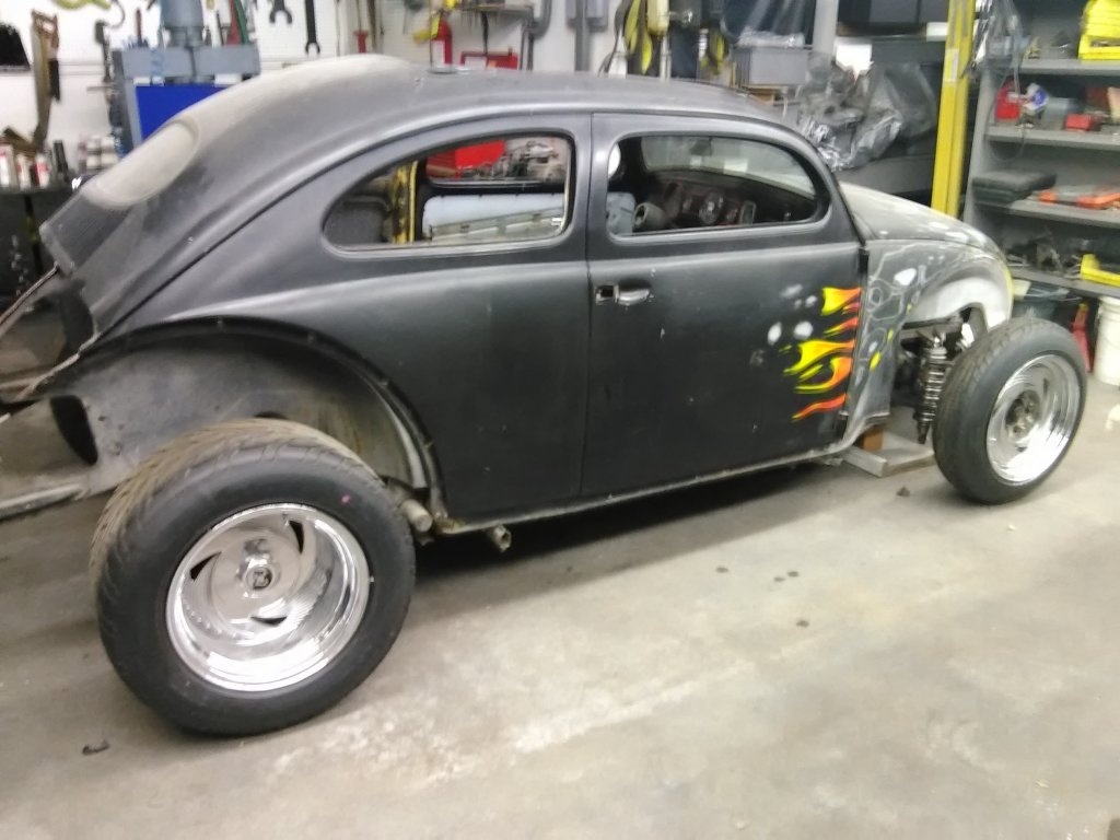

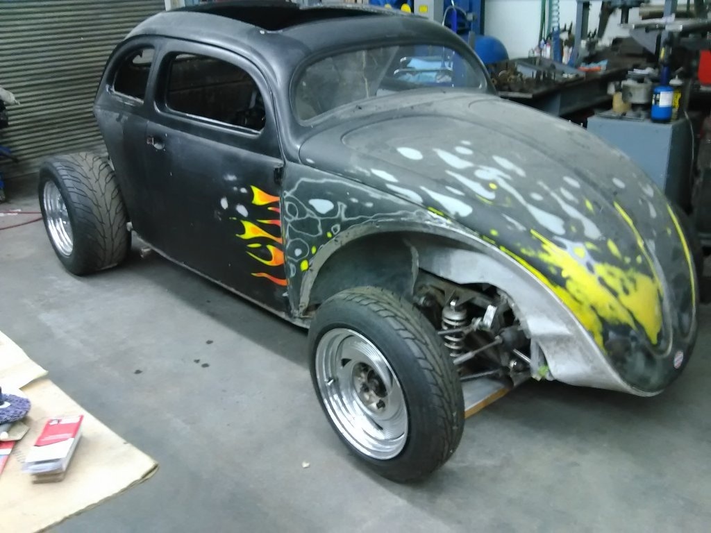

My opinion, and i have grow quite fond of the profile.....good looking tail, slims it up nice, be bad *** buhlack. Seen my chopped bug here? bc

Is that a V8 hanging out the butt of the bug? bladerunner
Yes, a lexus 4.0 ltr 4 cam, 4 valve.....
KEP made the adapt plate & flywheel....8 bolt fly/crank mate.....t-axle is 67 porch 911 S, stock PP is 215mm, i uped to 228mm, w/ 300 lb, heavily scintered disc. My Late Brother Will built the chop in 70's, the actual roof cut He did late 76.....on 3.5 yrs hobbyist exp. Bod is 56 on 72 IRS pan.....if You noticed front suspension & sub.....that was all hand fabbed by a Guy who worked w/ Lotus in 60's, He built Super Seven chassis. 4 whl drilled discs, type 3 cals in front, 914 in back....think i found correct adaptors to do 4 piston Wilwoods!
Porch final drive is 3:55....im going to kick it to around 2:10. Stock the lexi is 250 hp/260 tq....im only looking to 300 hp....turn key weight will be around 1800lbs. A run on Bonnie is a Hope....never been to salts, figure why not do it with a ride,,,,not seriously compete, just to say i done it. This little car can straighten a road as well as any 930/5.....lexi is 10" longer than VW, stock weight fully lexi accessorization is 400lbs, which ive pulled a good 40 lbs off...only things ill have to run is altetnator & water pump. Not a weather car. Im like a Custodian, car is Family Heirloom, Will's Son Chris left the car in my care cuz He left country, but eventually car will go to His Son. After im dead of course...lol
