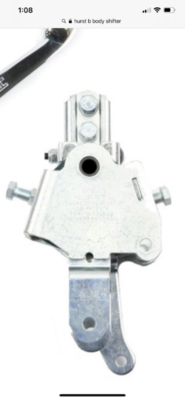

Passon performance told me the console mechanism is different. The guy told me the mechanism I have (hurst Aftermarket) wont work and I will need the mechanism that leans towards the back seat.
That’s because there is a “pinned” and “bolt on” shifter. The handles are the same, pinned or bolt on.

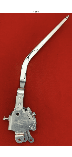

I have this one. You can see In neutral it points to the sky, my last post the shifter handle mechanism is tilted back 10-15deg or so. Passon says that is the correct part I need.
No way I’m Planning on spending $600+ though, I’ll just bend my handle with a torch. My handle is NOS though so I’m kinda gritting my teeth over this.
Hurst says my shifter is good for 65 with console so once again aftermarket vs reality might be 2 different things
Then get a replica shifter handle and don’t sweat torching it. Also that shifter in the pic is a bolt on handle mechanism, Mopar didn’t have bolt on shifters/handle till later on, not sure of the year, but 65 definitely did not have it.
